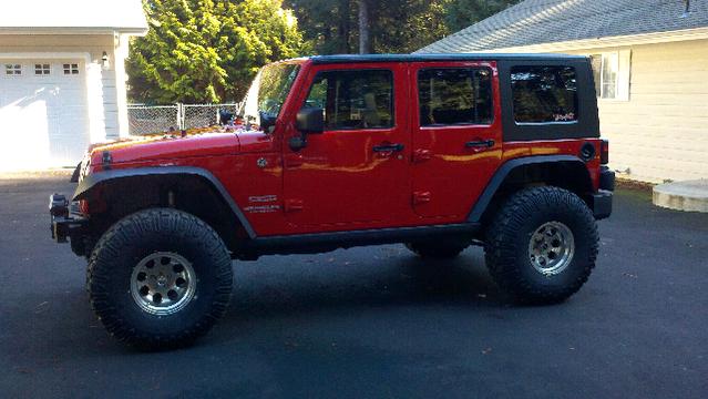

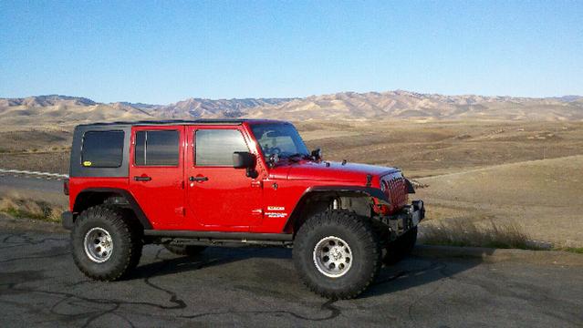

I just bought 37" trxus mt's a week ago and love them so far. I have a 2.5" Tf coil lift with cut stock fenders.

Like all Super Swampers, they are made in a clamshell mold rather than a segmented mold. This means that they are usually very out-of-round in these larger sizes we run. If you're primarily an off-roader, Swampers are great. But for daily driving, you can do a lot better. Sure, you might get lucky and get a set of 4 or 5 that are nice and round. But I've never owned any Swampers (and I've owned a LOT since I started in 1994) that are anywhere close to round. If you like vibrations, Swampers are the tires to buy.
