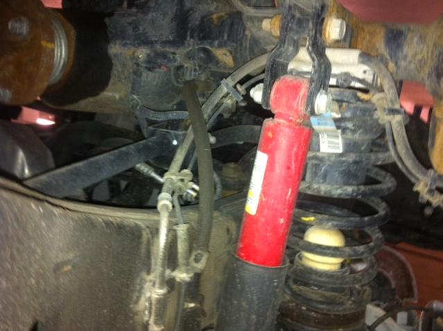

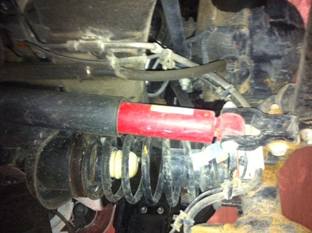

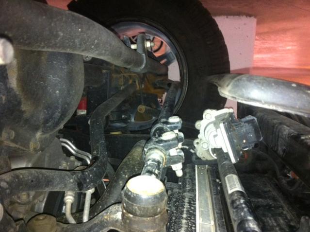

Some quick snaps underneath. Are my bump stops supposed to be so close to the bump plates? That's not a lot of spring compression before the bump stops connect.

First your sway bar should be parallel with the ground not at an angle. Are your tires balanced that could be why your shaking much. Your bump stops look Ok they aren't that close.

Yes you need to extend your swaybar links. I don't think this is your issue if you did not have issues before 37's. Most BB kits supply longer rears and you move the stock rears to the front. You want parallel +/- a few degrees at ride height.
The yellow bump is not your actual stop. That's like a cushion or a shock. The actual bumpstop is the hard plastic/rubber the yellow jounce is pressed into. The bumpstop extension is the block attached to your lower coil perch.
