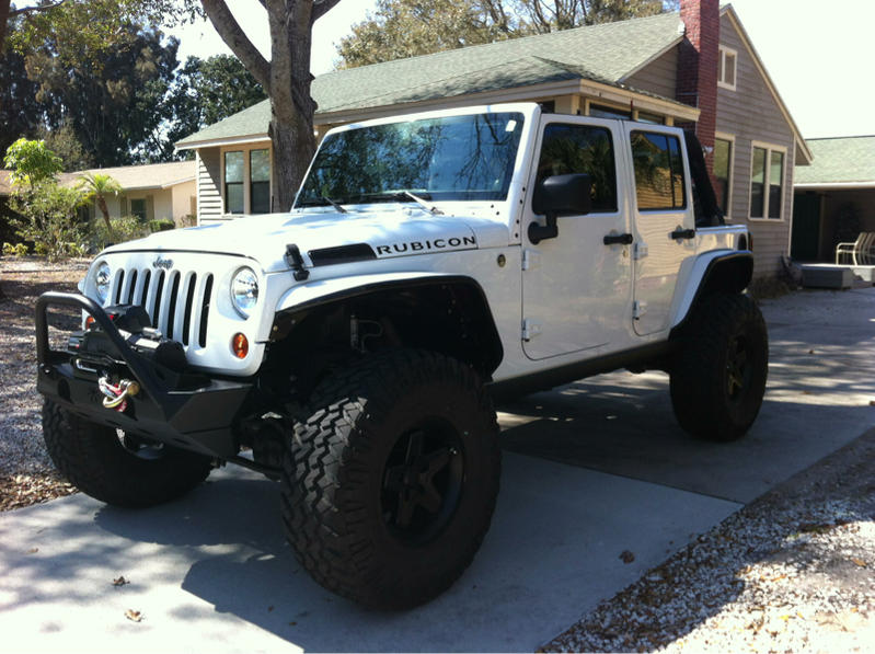

I would do a 3.5 lift with flat fenders. I think it's a perfect combination.
Attachment 427582
Are those PS fenders? Also, what winch is that?
Thanks, David M
Old Feb 27, 2013 | 02:41 PM
1LuckyJK's Avatar
Posts: 439
From: Palm Harbor, FL
Yes PSC fenders and Warn Zeon winch. Its a crappy cell phone pic.

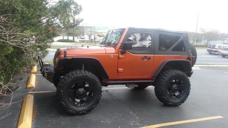

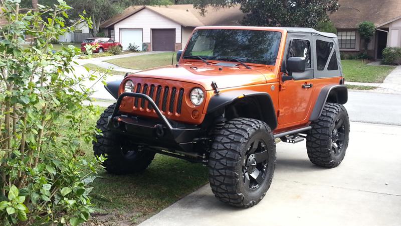

Im on a rc 4 inch lift. Swapping out the nitros for the 5160s this week and 511s. Love the height and very little sag just not loving the ride so hoping the billsteins will smooth things out. Hope this helps.
<img src="https://www.jk-forum.com/forums/attachment.php?attachmentid=427606"/>
Thank you all for the info I don't know much about gears so really the question was more so someone can tell me what's the difference between let's say the 488 and the 513 gears will it keep the same power as now or drop with 37 and about the lift I did a bit of looking around actually a lot of looking around and so far the AEV I like but like a lot of ppl say can't believe what the company's are saying cause they all want to sell what tey have to offer was looking more of what you guys already own with real life driving to make up my mind thank you
Old Feb 27, 2013 | 05:18 PM
Bill Maris's Avatar
Posts: 20
From: Gracefield Canada Quebec
Your ride is sick love it and the color is awesome
Old Feb 27, 2013 | 05:20 PM
Bill Maris's Avatar
Posts: 20
And those Nitto mud grapplers are holy smokes perfect makes your jk come out from the rest
