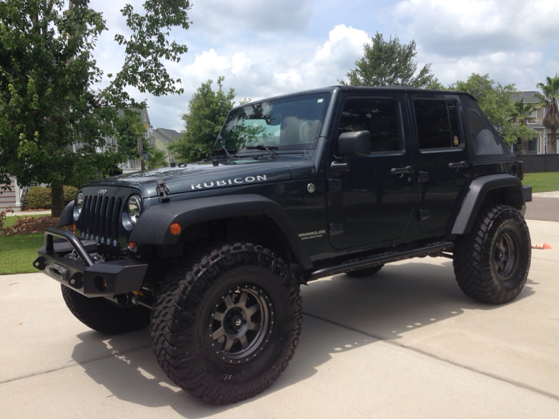

I just built an 07 on 37. Mine had 115k on it. I had synergy 3" could on it, drag link flip kit, truss, new tie rod, new drag link, 4.88 gears, chromoly shafts, all 8 arms, c gussets, drive shafts, sector brace. All in all about a $13k transformation. It is more than just slapping on the rubber. If you are prepared for that, then go ahead. If not, get prepared before you dive in.
Looked nice though.
sent from my work leash

Sweet ride Matt!!!!

<img src="https://www.jk-forum.com/forums/attachment.php?attachmentid=620157"/> Looked nice though. sent from my work leash
That is a good looking jeep!! 👍

Thx guy not mine anymore. Sold it last Friday.
