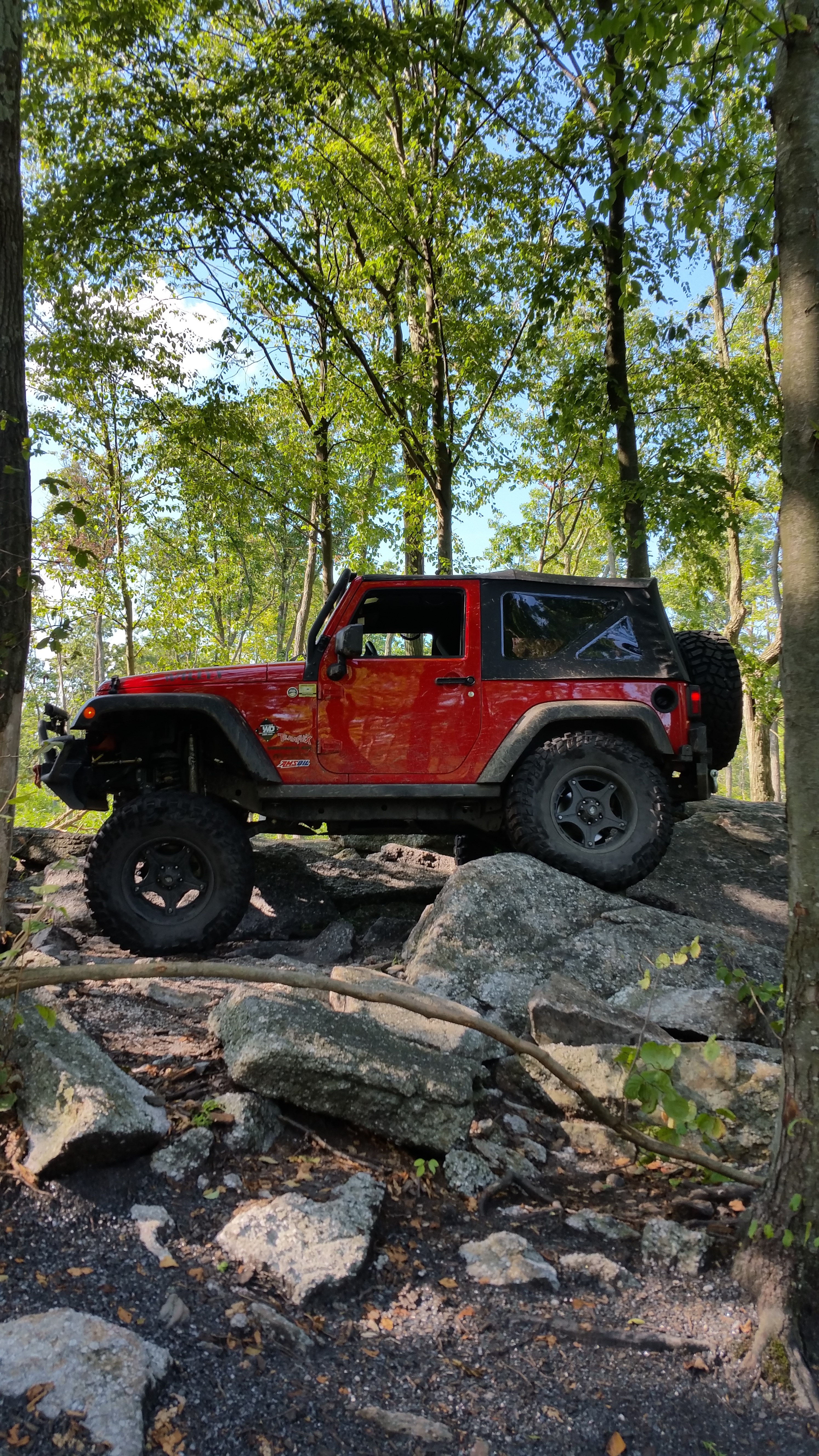

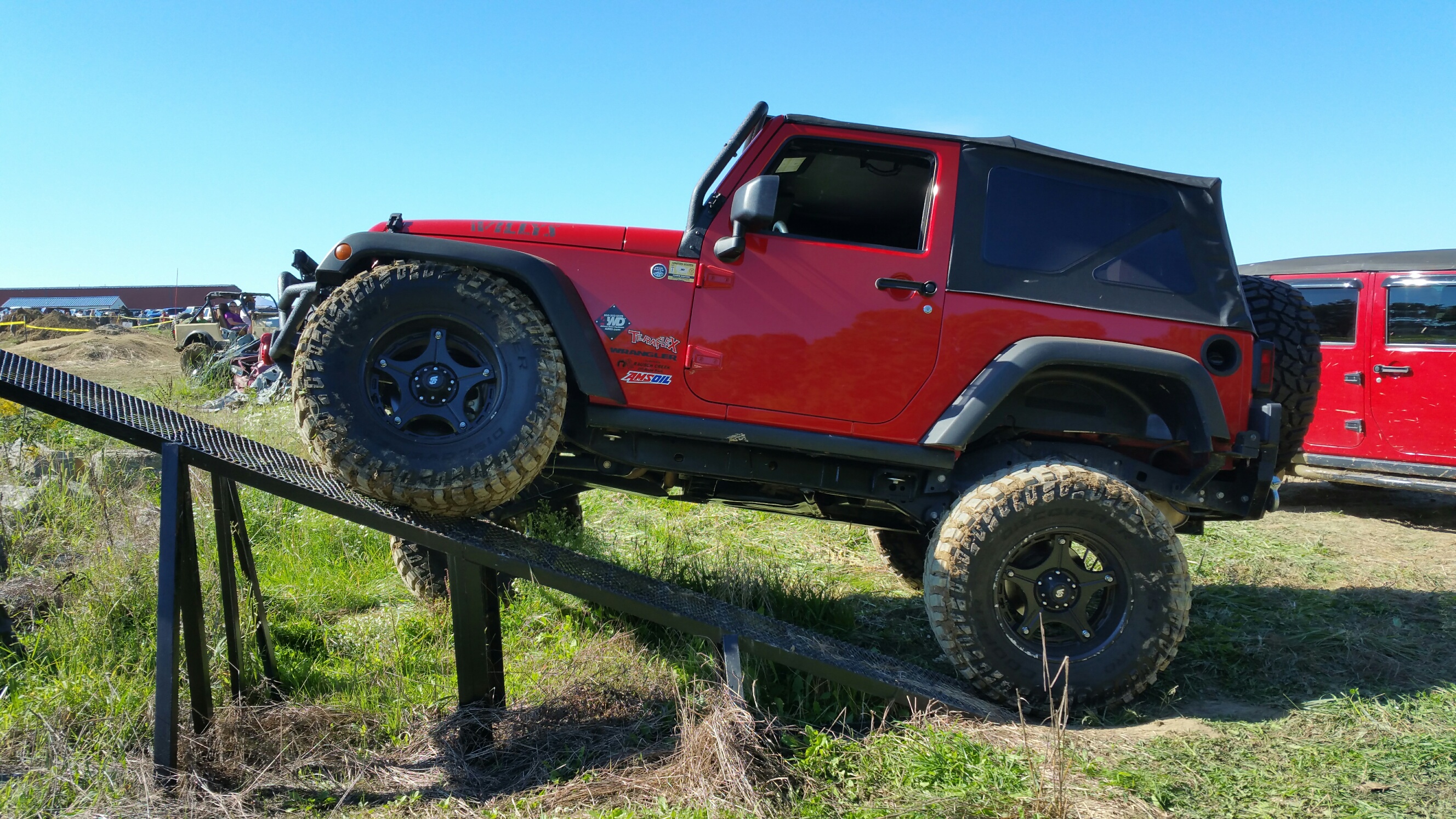

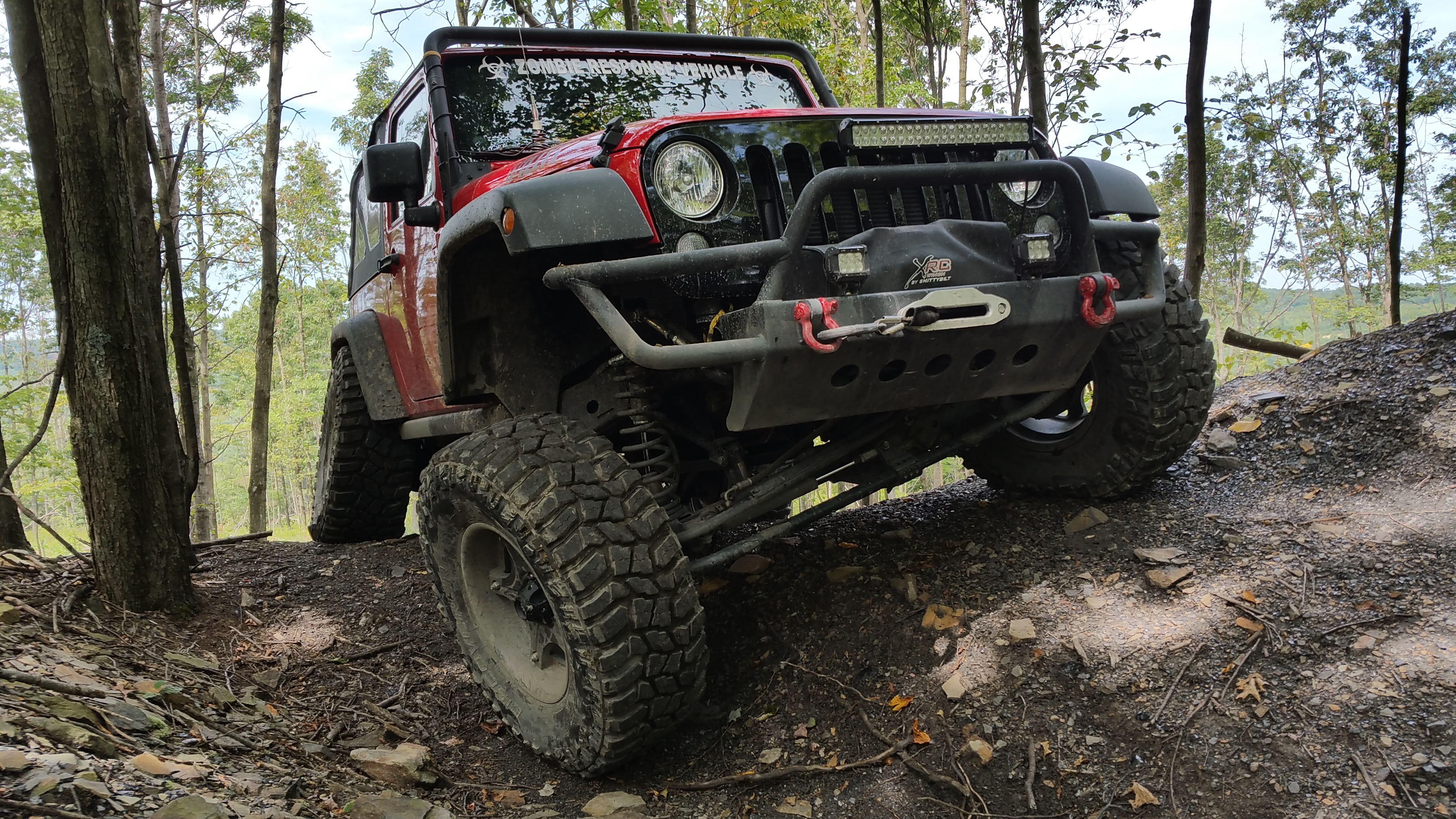

Originally Posted by MrChuckles
I'm running 37's on 2.5" lift and flat fenders. Like the guy above me said, make sure to trim your rear pinch seam, and if you have any rubbing, just add some washers to your steering stops.
With stock control arms and 2014+ model, you do not have to trim anything at all aside from the Rubicon rock rails if you have them.
I use a Rock Krawler 3.5" spring and 1.25" body lift and use bump stops to stop my shock shafts at about 1/2" from full collapse. Disconnected and at full twist, I touch my flares enough to make noise, but not enough to hurt them with 37x13.5 tires. Jeep took care of the cutting on the 14+ unless you push the rear axle back with aftermarket arms.
3" bump in front and 4" in rear.
