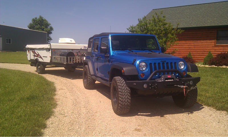

My wife has a 2010 JKU as her DD with 3.73 gears and 33" Nitto Trail Grapplers. Steel wheels as well. Very heavy rotational mass setup for sure as the Nittos are very heavy. The tires killed the power until we bought the flashpaq. It restored it to where it doesn't downshift at every little hill we go up. Can set the cruise at 70 and it won't come off of it going up a hill now. Before the flashpaq it would drop to 65 the downshift and up the rpms like it was going to blow up.she drives 60 miles round trip to work with her Jeep. It pulls our popup camper pretty good now too. I wouldn't be afraid to pull it to the mountains from here in central Kansas.
