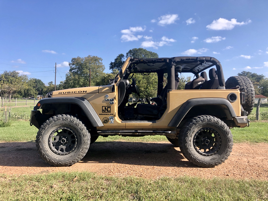

I'm stepping up to 37s (and 5.13s) next month (currently on 35s), but I've done a bunch of upgrades to get me where I am: Click image for larger version
Picture of it on 35s from before installing all the adjustable control arms.
