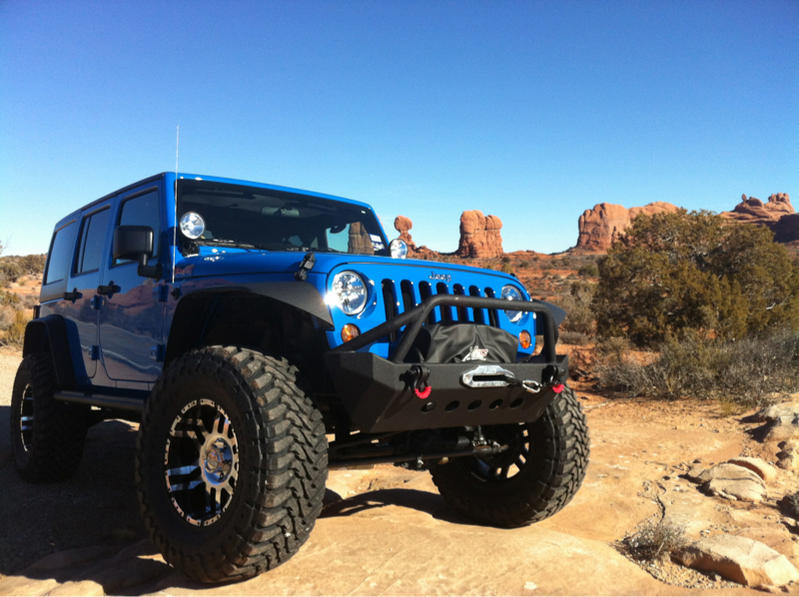

I have a 2011 4 door with heavy 37" Toyos and still running 3.73s for now. I am in the process of saving up some cash for 5.13s or 5.38s...
I have lost a lot of small power the 3,8 has to offer, but its still drivable around town, but i dont really do any highway driving because it doesnt seem to take the engine/trans to the limits...

I will be investing in a trans cooler along with the gears here shortly. The front dana 30 can wait, because if it does bend or break then i will have a reason to upgrade that later!
