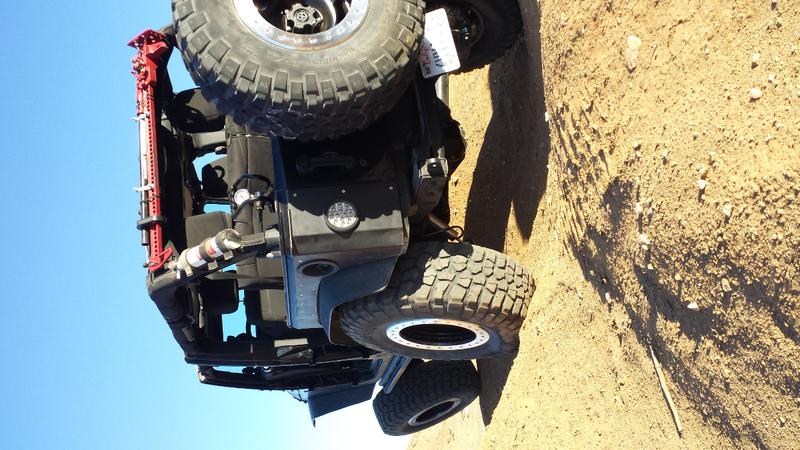

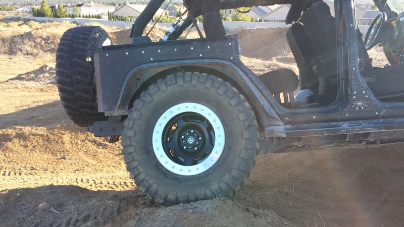

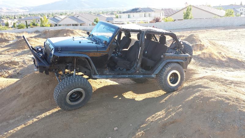

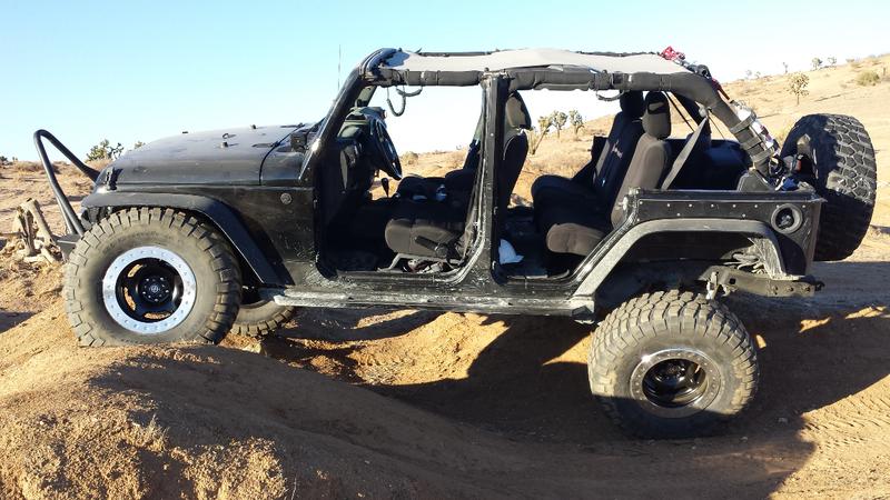

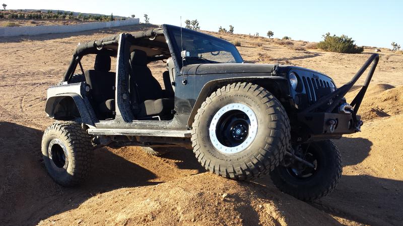

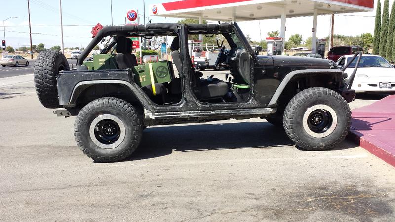

Just got my atx slabs put.on yesterday. Running a 2.5" rk lift, trimmed fenders and 37's. I had a 1.25" body lift but I removed it to lower my center of gravity.

Looking good! How do you like this lift? Im running 37s as well and was thinking of getting the 2.5" RK lift! I heard it nets about 3.5" actually but Im in the same boat you are. Wanna keep as little lift needed to clear 37s. My current 3.5" RC lift Is about at the end of its life!
Old Aug 29, 2013 | 06:39 AM
bob-o's Avatar
Posts: 2,215
From: rosamond, ca
Thanks a lot. I really love these rk coils, they are so much smoother on and off road and flex pretty darn good. When I first put them on, I netted about 3" with just the front bumper, right now its at 2.5" with the winch and my homemade stinger on. I only have the coils and im still using all 8 factory control arms for now but as u can see in the pics, it still flexes really good. I definitely would recommend this kit.
