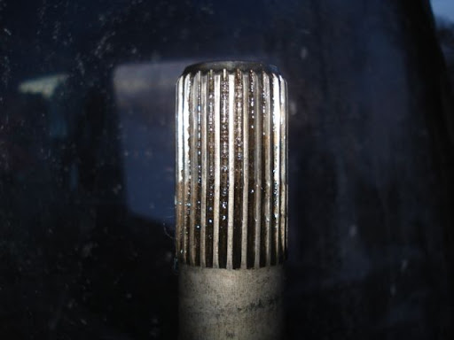

Originally Posted by VaNomad0530
Ok, so I've been reading as much as I possibly can on the topic of 37's. I'm running everything stock right now and plan on doing a 4.5" lift, gear change to 5.13's, and was HOPING to be able to go with 37's. I'm thinking now that 35's will be the better choice. However, I'd love to get 37's in the future...anyone know exactly what I need to safely run 37's?
Thanks for the help!
There is NO safe. I just busted a shaft running 35s and being open. Imagine 37s, smaller R&P and locked...
This past Sunday.

Besides the rotational mass of tire, you now have a longer lever that the shafts and driveline must push. That is how you end up with parts that look like the ones in Suffolk's post.
