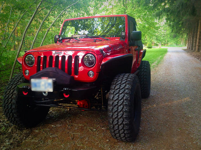

He built it for show and shines mostly and drives it as a DD. It obviously rubs a bit at full lock but so do 37s on a stock axle even with spacers. Most Ontario trails where we are mud and dirt and rock, it's nothing like what you'd get in the SW. Most of our parts I've seen damaged are from mud and grit getting in where it shouldn't and grinding away. We usually don't notice Anything break until we start to drive out onto paved roads and get upto speed. It certainly wouldn't hold up to regular weekly wheeling though, especially heavy rock flexing hahha.

I guess some of it goes back to how you drive it. Like too much skinny pedal too often will certainly have much more significant prolonged effects than someone who just crawls at slow speed along the whole trail. There's just so many variables to it. Also here's a 2dr on 40s with a dirty 30 haha

O well now that you explained that i feel anyone can run 40s on a d30 if they are careful..
