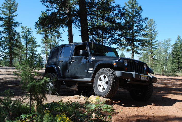

So I’m bring a topic back to life.
I always thought I’d stop at 35’s but recently made some upgrades to my JKU that have me questioning 37’s. I’m looking at 2 sizes of tires from 2 different manufacturers. ( I’m not going to name them because I don’t want this to be a brand argument.)
I’ve read the threads and everyone says with 37’s you “have to upgrade shafts” and “you will need to upgrade this and that” and “you will lose performance”. The question I have is…why??
This is why I ask. I am currently running the tires size 295/70R18.. roughly a 34.6 x 11.5 that weighs in at a whopping 82 lbs.. The tire I was considering going to 37x12.5R18/D Actual Size 36.8 x 12.5 weighs in at only 72 lbs. So I ask, wouldn’t my current tire create more wear & tear and do more damage to my MPG and on road performance than the 37’s?
Also since I'm technically running a "34" if I were on a 35 going to a 37 only adds an inch and a half or so.. I don't see how that could be the breaking point.. could it?
Side question.. can I get 37’s on my specs in my signature?
