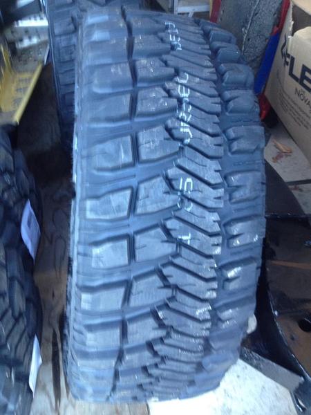

Default I think if more people saw these in person, it would change their mind...
ID:	537110Click image for larger version
ID:	537111Click image for larger version
