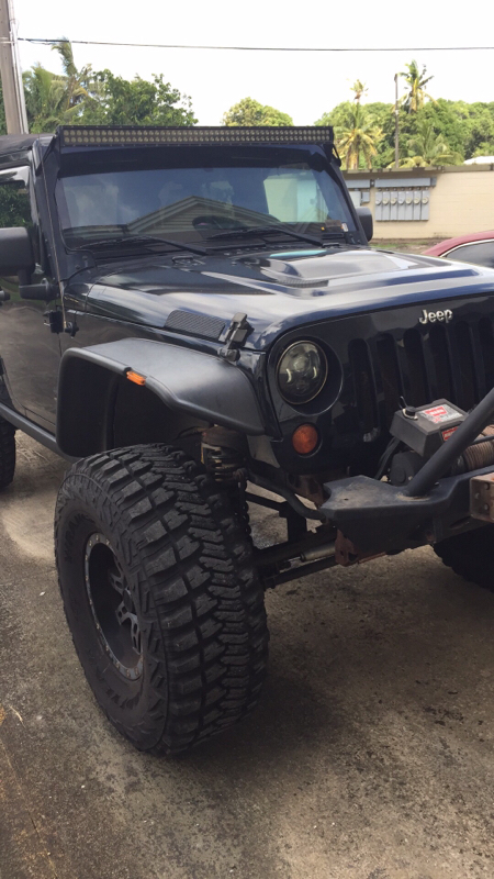

I could use some help. I made the switch from 37 inch Super Swamper MT's to 38 inch Goodyear Wrangler MTRs. I am stationed on Guam so my options for tires are limited. They did not have 37 inch MTRs in stock and I thought my JKU could handle the inch size increase, being sleeved and gusseted with the D44 in the front but now I am second guessing it.
I had them mounted and saw that with the increase I needed to move my axle back to recenter the tires because I could not trim the pinch seal any further. I was unable to do this because my lower control arms were seized and needed to be replaced.
I drove around on these 38's for some time, they affected the characteristics of the JKU significantly where it took a lot more effort to get the jeep moving compared to the old 37's. I couldn't off road for fear of hitting my rock rails so I was on the street until I could get replacement lower control arms.

That's a very wide tire (14.5") and as you've noticed will affect drive ability. That's a lot of rolling resistance you have. The general rule is running 38s requires the same preparations as 40s.
Are your tires rubbing when cornering causing the esp to kick on?
The other consideration is, I believe, that MTRs are usually truer to size, so a 38 in MTR pretty close to a 38" diameter. Not sure about the 37s you run. (example, a 37 BFG usually comes in about 35 1/4 true diameter). Perhaps you've got a similar situation where you've effectively increased the measured diameter by 2 or more inches. Maybe?

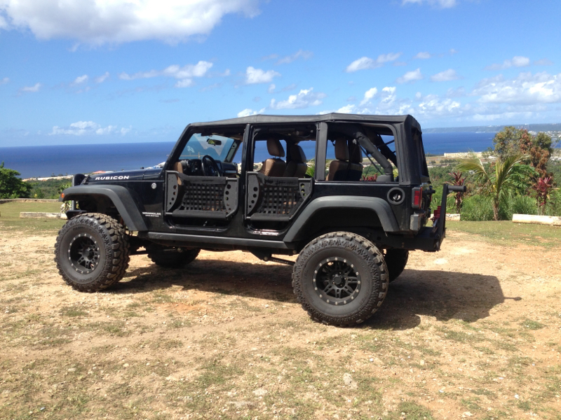

Wheels & Tires:37" Super Swampers on 17" Pro Comp Rims, skyjacker dual stabilizer
