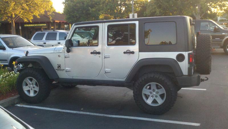

X2 but i actually like coils. Get 2.5 teraflex coil lift with shocks and wheel spacers and get someone to help you install it here on the forum. It is Easy to do it yourself and save some $.I had a leveling kit on first now i have 2.5 coils with a 1"spacer for 3.5 total lift with 1.5 spidertrax spacers and 34"toyo mt 285/75/17. My mpg average is 16 and
its my dd as well. Good luck
