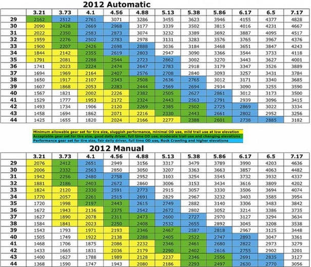

Maybe this can help

The difference between the two is about 10%, which isn't much, and you'll be OK with either, as you can see in the table.
However, if you think you may want 37"s in the future, the 4.56 will be waiting for them.
Tire sizes are, BTW, nominal. The true size is typically about 1" less, so most 35"s are actually ~34".
The table is for nominal tire sizes.
