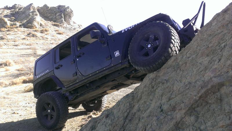

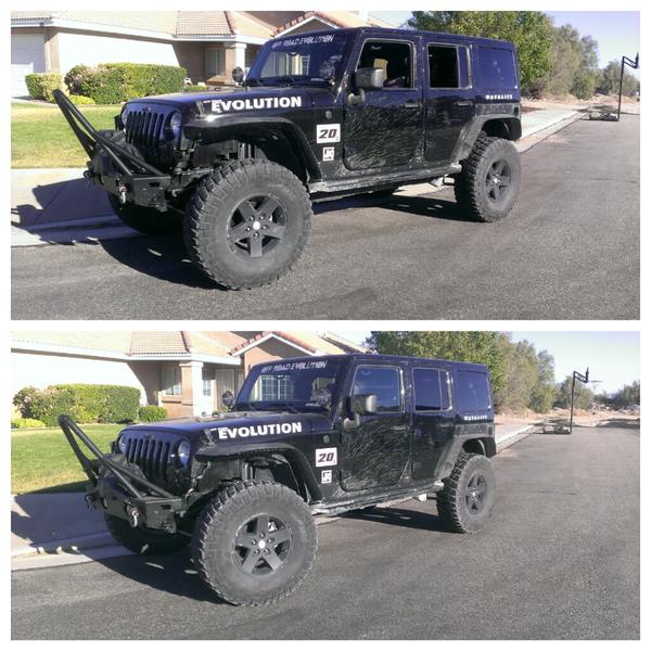

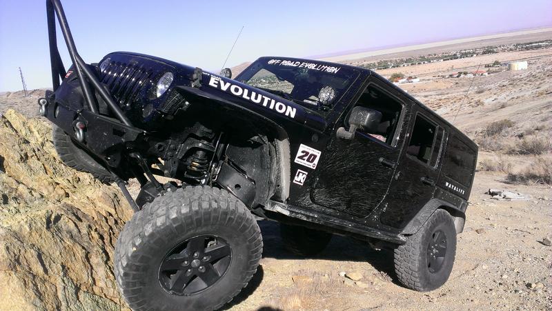

The top pic is 3.5" and 37's, bottom pic is 2.5" RK same tires.

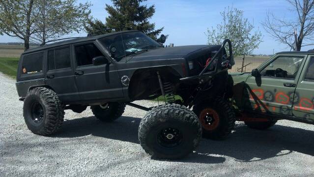

Looks good. I might just wait until I get 37's before I change anything.. Are long arms worth the money on jk's? Stock they flex out pretty darn well.. I like the low and "big tire" look.
My old xj flexed out

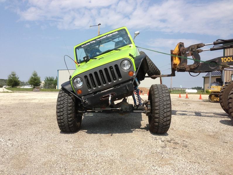

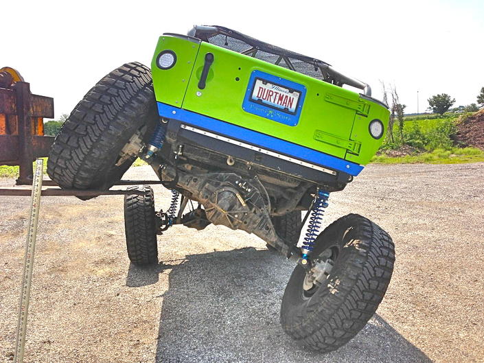

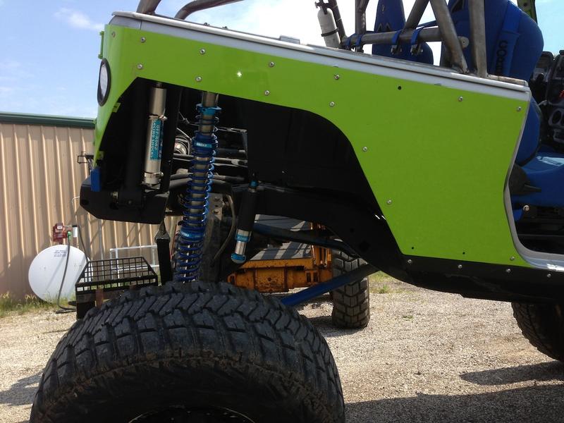

You can't get flex like this with a short arm. 45" off the ground with 40's and 4" of lift. 16" rear travel shocks and 14" travel fronts.
That's pretty impressive.. I only had 12" travel on my xj with 4" lift with 40s. I was also running leaves in the back. Still flexed like crazy though for what it was. Looks good though man. Got me thinking now lol
