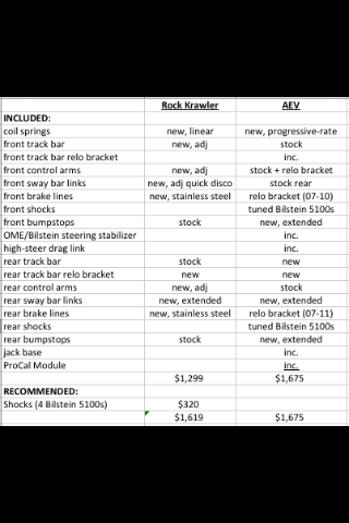

Someone put this comparison together which I thought was interesting

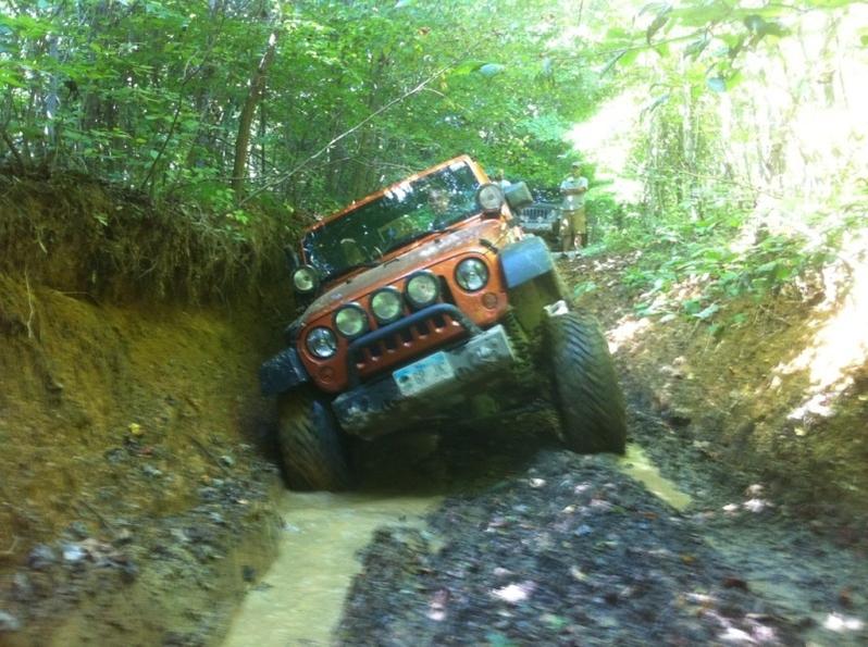

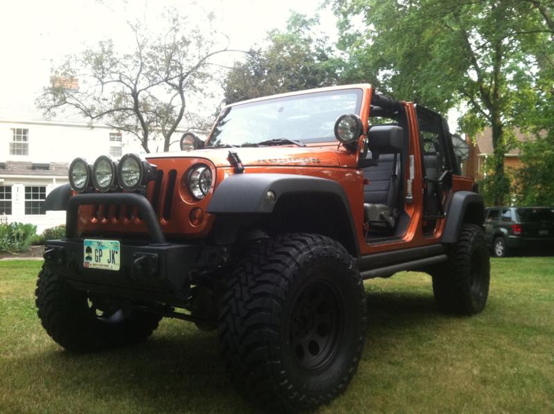

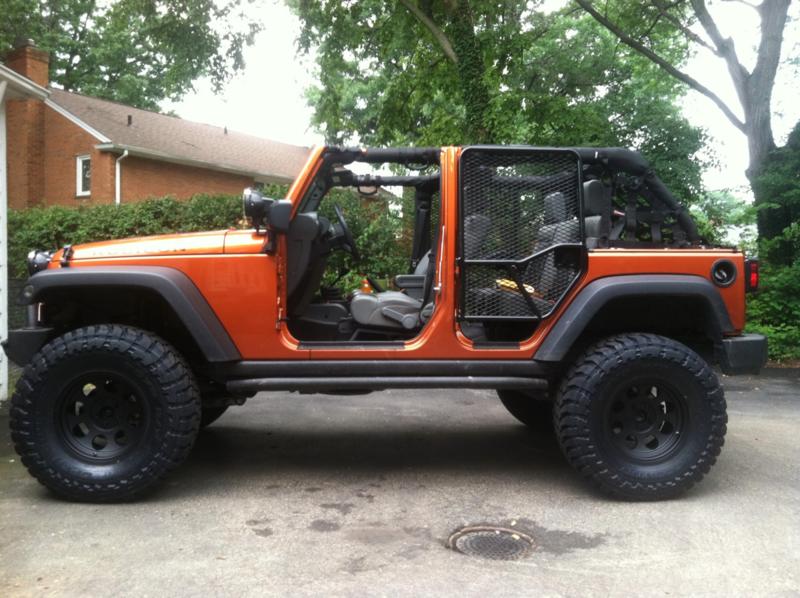

I have an AEV 4.5" and really like it. Rides great on road and has met every challenge I've wheeled Offroad. 37" Toyos at 28 psi is smoother than stock and not any louder.
