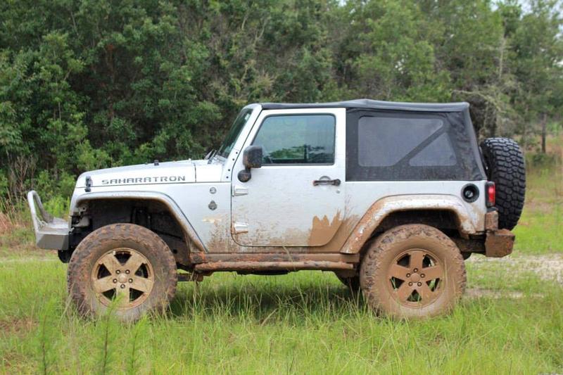

That doesnt look much taller than mine, or are you running 37's? Maybe i need to go 5.5 inches.

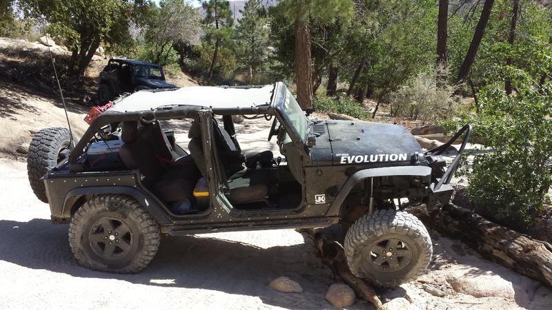

I'm running the TF 2.5" lift with front 2.5" Rk springs on 37's. Just came back from big bear last.weekend from running John bull, dish pan springs and Holcomb creek. No rubbing any where
Attachment 484472
Yep. 37 mud grapplers.

What size/how much bump stop? What do your BFGs actually measure mounted and what size is actually on the tire?

Im running 2.5" bumpstops front and rear but I also have bilstein.shocks for a 4" lift up front and 2" rear.
Right now with the tires mounted, with about 40% tread and 30psi, they measure just a hair about 35.5". Brand new they measured 36.8"
