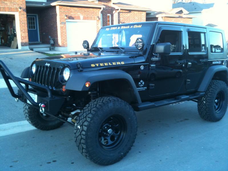

Originally Posted by hagausaf
you must live in some flat ass area. I never saw 17mpg's even with stock gears an tires here in Colorado.
Where you live does affect mpg's for sure and driving habits like how hard you like pushing on the skinny pedal. I've seen 17.4 many times on my lifted 09 auto JKU lifted 3" (closer to 4") 35" tires etc with 5.13 gears and a superchip. Some guys like to drive jeeps like race cars and then bitch about mileage.... not saying you're one of them..... just to clear that up.
