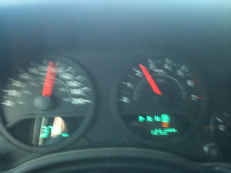

I have your exact set up..... Don't know what the other guy who posted has but his rpm's seem high. I have Yukon 5.13 gears.
Sorry for the horrible iPhone pic but I just remembered your thread as I was getting off the hiway and rushed a pic while I was at 70 still. I'm not near 2900 rpm. I can take a better pic in 10hrs when I'm off work if you like. I'm always at about 2500rpm at 70.
Power lol it's a jeep but it's fine and mind you I'm using a Superchip even before I regeared and after the new gears I did not lose any mileage. I do 60/40 city/hiway driving.

Hey robsjeep9, did u check out ur pick, showing 115mph at 2500 rpm, pretty cool. Musta been from the motion of the camera but that's a keeper.
Old Jun 27, 2012 | 04:54 AM
jaybrown's Avatar
Posts: 278
From: Newmarket Ontario
It's in kilometers lol
His speedo is Kilometers
