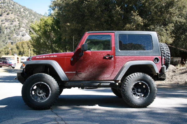

After installing the 3” Full Traction lift w/ HD front coils on a 2 door rubicon I noticed that my tail was slightly lower than the front end. My tail drag was even more noticeable when I loaded up the jeep for camping trips. This wasn’t a driveability issue, but it still bugged me. I discussed this with several people and came up with the following solutions.

5. Install Full Tractions new 4” rear coils. - This is the option that I choose. Available now from Full Traction. They charged me $200.00. Installation was very easy, I used Way-of-Life’s 3” FT installation write-up. Installation took only 2 hours. Installation leveled the jeep and provides a slightly higher spring rate for when I am fully loaded. http://full-traction.com/

Jeep unloaded w/ 3" Ultimate Lift. 3" HD front springs and 4" rears.
