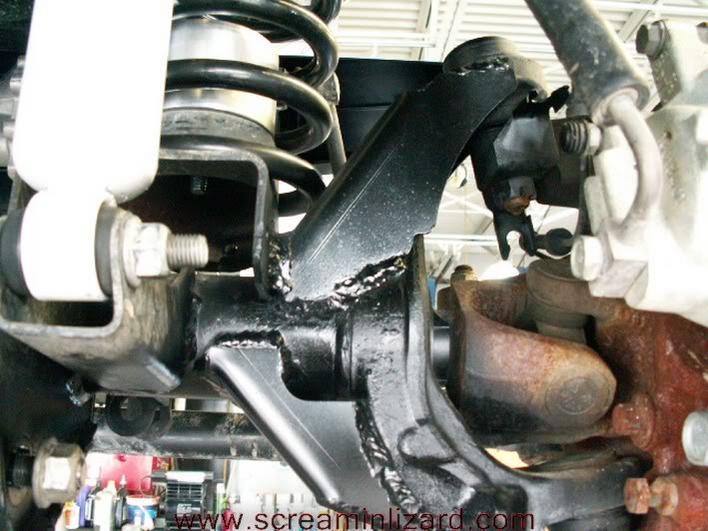

ID:	28461........ C-gussets

Track bar mount can be gusseted by a welder or you can buy them from different manf. Check this write up out
https://www.jk-forum.com/forums/show...rack+bar+mount
