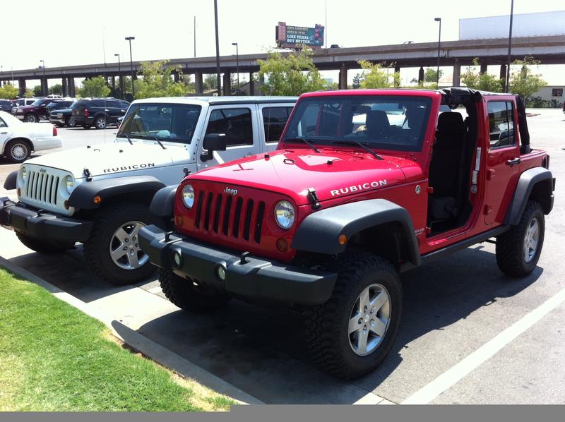

Originally Posted by jaynasty10
I would rather just get a 4 inch lift. Not just add stuff together. Anything on Rancho 4 inch?
Yep! On it and love it! Only $540 after the rebate. It includes the pitman arm drop and the track bar relocation.
