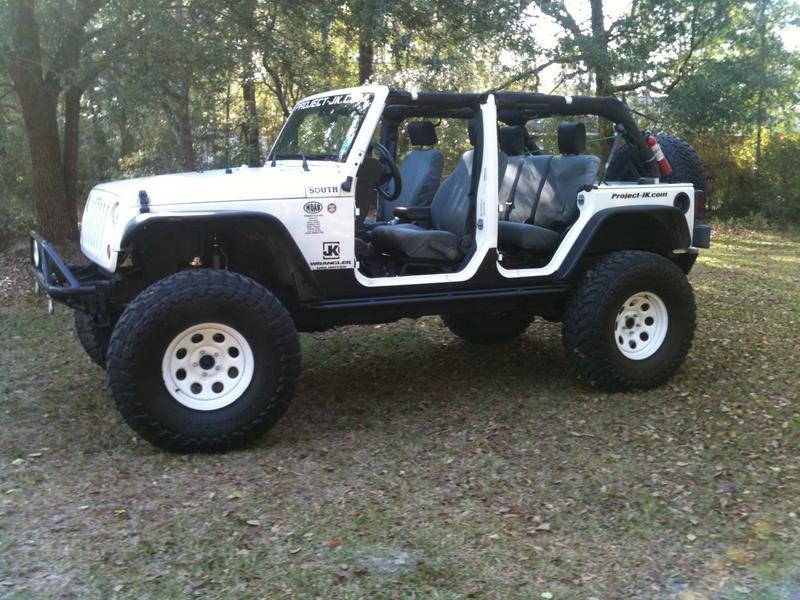

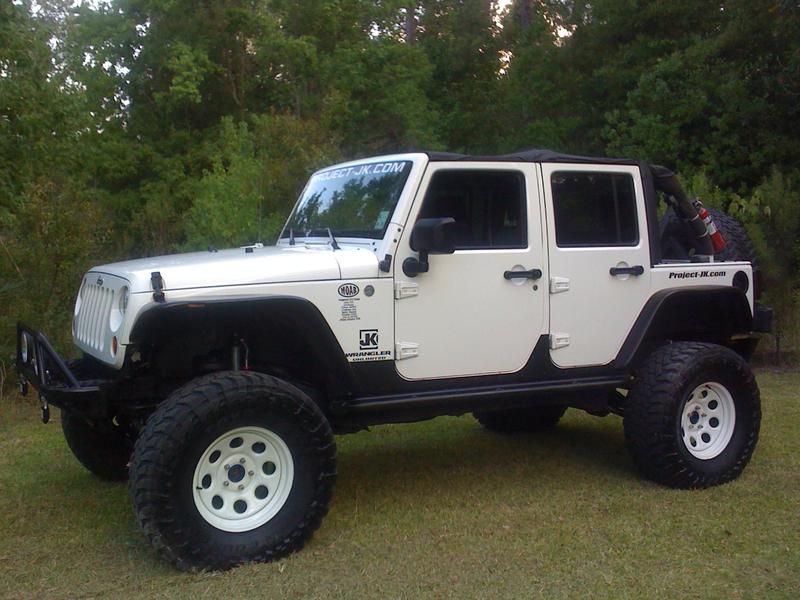

Whoa dude, a 2in spacer on the Tera 4in coils is gonna put you in the stratosphere. You'll be teetering around like a Cop 4x4 jk and dred a 10mph cross wind on the interstate. Here's what I did, Tera4in w/1in spacer, 1in bodylift, flat fenders, 37's. While I could have done without the BL or the 1in spacer cause I was running flats, it was already on when I ran a BB with 35's so I left it. I am running this same set-up on 40's now.
37's Click image for larger version
Name:	jeep 6-19-11 006.jpg
40's Click image for larger version
Name:	Nov 2012 004.jpg
oh, mine is the shortarm kit btw
Also, you really need to find out the extended length of your shocks to see if you could use them. If they are the same length for the 6in longarm, yes you could.
Driveshaft- You'll be in a vibe and or CV chattering range you may not want unless you want to deal with poor handling with castor.

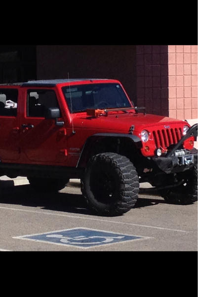

If anything a small body lift or maybe a small front suspension spacer like 3/4 inch. Other than that, trim your fenders, and get your 37's.
