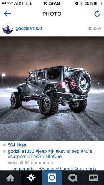

Thanks for the info! I'll keep doing my research. I saw this guys picture on Instagram and it's just too big if that makes sense. It's a 5.5" long arm.
That much lift is for mall crawlers. Not functional and creates all kinds of issues.
