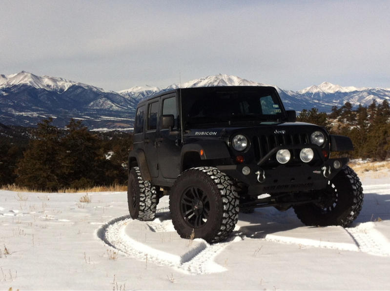

I have the rc 4" with 35 12.5 17s
I think the ride quality is great! I have a spot on my track bar where the stock steering stabilizer is rubbing. I do have the relocation bracket on. There is no sag even with aftermarket bumpers. I love the quality and ride if this life, I just don't know why this is rubbing on the track bar. Any input would be great? Other than that I love the lift.
