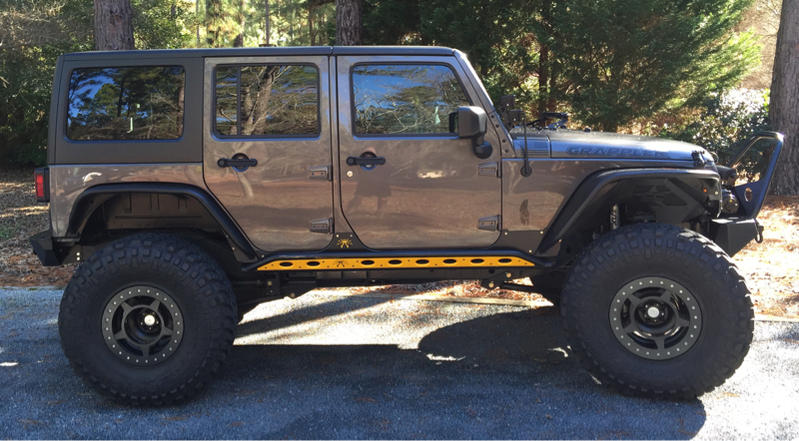

Adams 1350 with 40's.
I've been very pleased, zero issues with Adams and they are SOLID!
