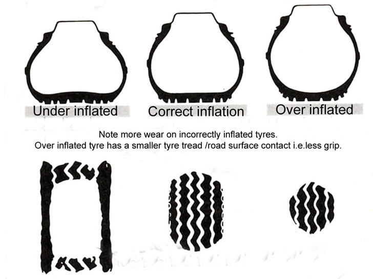

You're taking some really unnecessary risks with your life (and any passengers lives as well) by running with overinflated tires.
Your traction (specifically wet weather), steering, cornering, braking/ABS will all behave a lot differently without the recommended amount of tread on the ground due to overinflation.
Also, if you were in an accident you could automatically be at fault in many states if its determined that you are running an unsafe 'configuration' on your vehicle. All the accident investigator or the insurance companies have to do is check and then state that it may have contributed.

45 psi is way to much, even 40 psi is unacceptable IMO. I run my 315/70/17s BFGs ATs at 30 psi and I am very happy with the way the car behaves on road. I used to run them at 34 psi but man what a big difference now. Moreover dont overfilled tires damage other suspension components?like ball joints? I don't think is worth the extra mpgs.

Tire to road contact is important, over inflating is dumb. Under inflating should be reserved for the trail. Off road or multi terrain style tires have huge lugs on them already and make the tire footprint that much smaller taking away grip.
