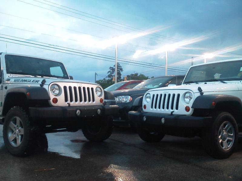

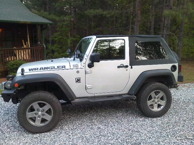

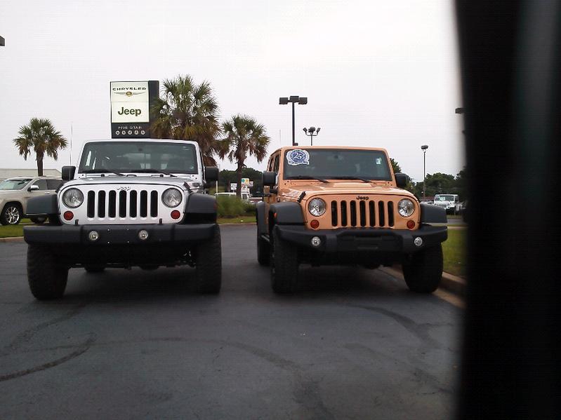

I had 14/55's on mine and installed 18/59 with TF 2" in front and 1" in rear running 255's for now and will add 315's....hopefully soon.
Pics next to some stockers for reference. I have never measured.
