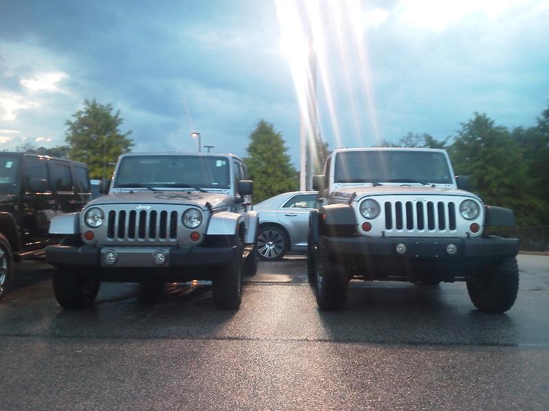

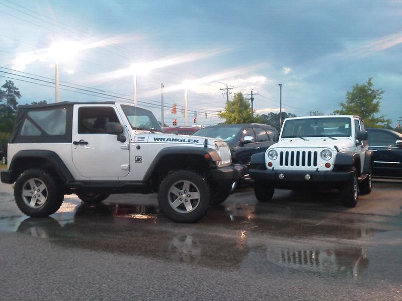

I had 14/55's on mine and installed 18/59 with TF 2" in front and 1" in rear running 255's for now and will add 315's....hopefully soon.
Pics next to some stockers for reference. I have never measured.

Originally Posted by miraclemax
And what kinda lift should I expect....?
I can answer only to the expected lift from swapping the coils. You will gain about 1 1/2" around and will level out the rake. I don't plan on using the spacer (TF level kit or budget boost). But you should be able to clear 35" tires easily. Keep in mine that you will need wheel spacers if you divide to go that route. Plus I would look at extending your front and rear bumpstops and brake lines. If your into water fording look at extending you breather tubes as well.
