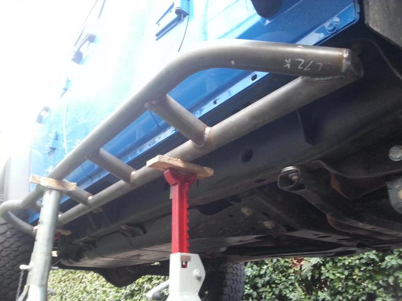

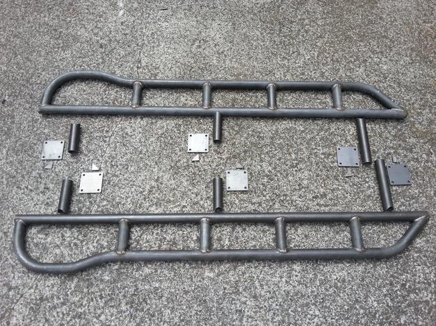

So, I've been taking a DIY approach to my JK and have so far have done all of my own installs. I have tried to keep my JK fairly unique, so it made sense to use a set of custom made sliders. I ened up going to my 'Yota roots and chose 4X Innovations (4x Innovations LLC). These guys market to the Toyotas, and I first heard of them on TacomaWorld back when I still had my '98 SR5. They are based in Wisconsin and use only American steel. Pricing is competitive with the foreign-made Trail Gear sliders and they came out at around $280 shipped. You obviously have to have access to a welder to install these.
The only measurement Adam needed to create a custom kit was the length. Since I will be trimming the pinch seam when I remove the Rubicon rails, this will be 72". I went with a kickout and am going to angle the sliders at 30 degrees so that they can serve as a pivot point as well as a step for my little guys without looking like running boards.
More to follow.

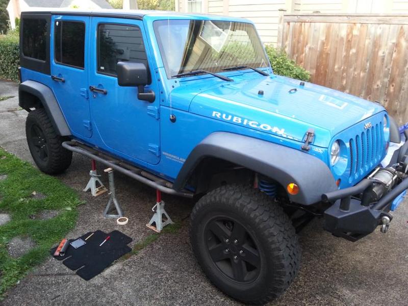

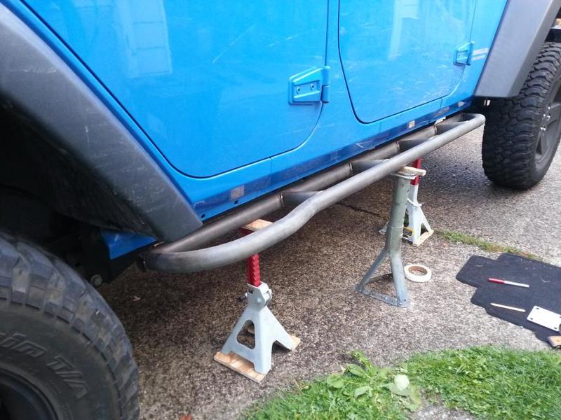

Well, just about every weekend has been booked recently, so two months later I'm finally moving ahead. I took off the Rubicon rails and put them on Craigslist Sunday night and already had a buyer pick them up. I'm COMMITTED!
Spent Sunday evening working on placement and taking measurements. Cut the stand-offs to size last night, and will be welding them on tonight. The corner of the rear pinch seam in photo #3 will be trimmed back 1.5-2" at a 45 degree angle to both clean it up and make room for larger tires (someday).
Thinking of bedlining the lower rocker panel and pinch seam. I considered the Bushwacker rocker and sill plate "armor" (they're plastic) just for aesthetic purposes, but at $160+... meh.
