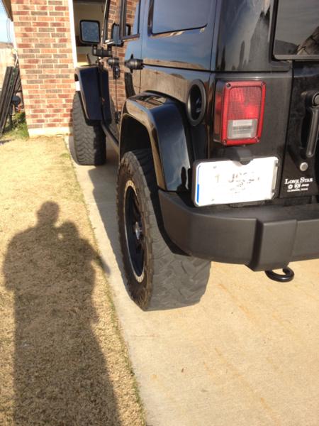

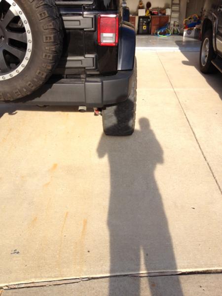

I'm running 35's on 20x9's with 20mm backspacing with a 2.5" TF lift. I think it measures to like 5.75" of bs No rubbing at all on the road, but we haven't taken her off road yet to see if anything will rub when flexing. It doesnt look like it will be a problem though. I personally like the look because the wheels are tucked in the fenders but stick out just enough to make it more aggressive than stock stance.

Here's a couple pics of how mine look
