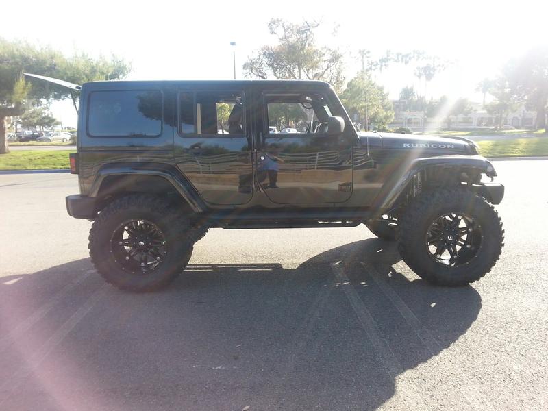

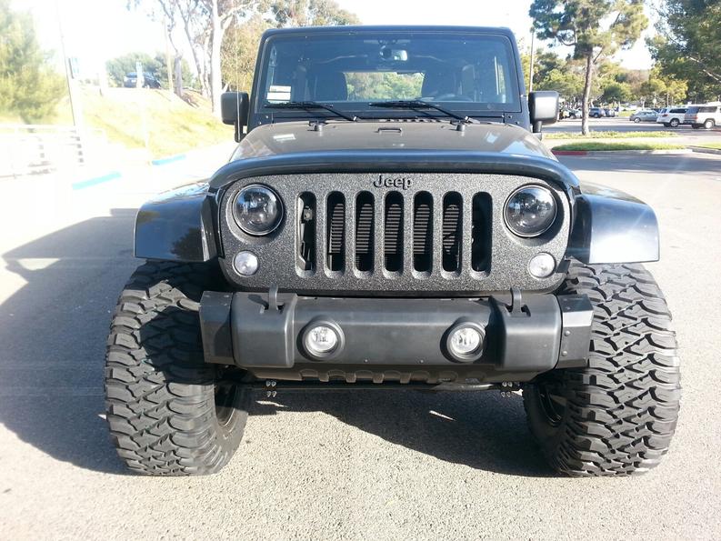

Originally Posted by jknewbie1981
Looking to go to a 6" lift. Besides the drive shafts which I already have what other upgrades would I need? Its a 4" lift thats on it right now with a 1" body lift. Just ordered 40's and gears. Any suggests are dually appreciated.
I have the RK 5.5 Mid Arm on my rig with 38x15.5's and I am pushing it on the stock 44's. I am keeping my stock flares but if you were to go flat flares you could EASILY clear 40's with this set up. Mine is a pavement pounder (No rock crawling). My off-roading consists of Desert and snow driving in the winter mountains and I am honestly a little paranoid of my stock 44's. Did the Artec Truss and c gussets just for a little insurance. Keep in mind though my Wheels/Tires weigh an ungodly 150-160 Lbs a piece (Weighed on my bathroom scale so not sure) so that doesn't help, but my 38's are true 38's. My rig is definitely on the big side. Mine is a 13 and I did the 5:13 gears and love them. I would have gone 5:38s if the pinion wasn't so small.Click image for larger version
