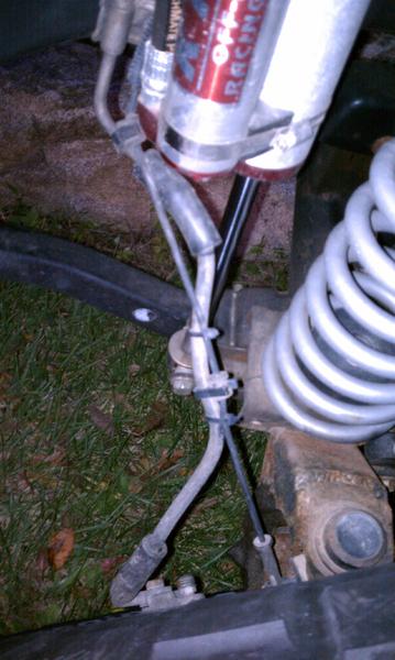

Just picked up my JKUR last night! Super excited! It has a Rubicon express 3.5 lift (stock ca) and 37 tires.

Flexed it out to measure things out. Shocks are good to go, and so are brake lines front and rear. But I don't like this other line being as taut as it is. What is it? I assume its some kind of Abs/speed sensor line. How do I extend it?

Old Oct 3, 2011 | 02:09 AM
Biginboca's Avatar
Posts: 1,127
From: Delray Beach, FL
Yes, that is the abs sensor wire. Maybe you can get enough slack by uncliping (seperating) it from the brake line?
I guess you can also splice an extension into it, but that would make me somewhat nervious. Need a wire of similar flexibility, like maybe purchase an oem replacement wire and use it for your spliced extension.

Old Oct 3, 2011 | 05:34 AM
19Delta's Avatar
Posts: 246
From: Northern, In
Originally Posted by TheDirtman
You can pull some slack out of it by adjusting the rubber mounts at the upper knuckle, you can also bend the bracket a bit to give you more slack. The abs plugs into the wiring harness right behind the frame member and you can unplug it an relocate if you want, just watch that it is not going to catch on the coils.

Originally Posted by Dutchboy101
I believe someone does make longer ABS/Speedsensor wires, just can't remember who

JKred's Avatar
Posts: 1,467
From: Torrington CT
Cut all the zip ties off and re run the lines, making sure to pull as much slack as possible...
There's plenty of line there if you run it right... Tho what year is yours... When one of mine broke (non trail related) I got a new one from the dealer and found it was much longer than the one on my 2007

Originally Posted by JKred
... Tho what year is yours... Web one of mine broke (non trail related) I got a new one from the dealer and found it was much longer than the one on my 2007

Originally Posted by 19Delta
07'.... hmmm, how do we figure that out? Maybe certain years are longer?
That's what I was told... And now my driver side front one has FAR more slack than the passenger side... It was $13 to replace, might do the other 3
