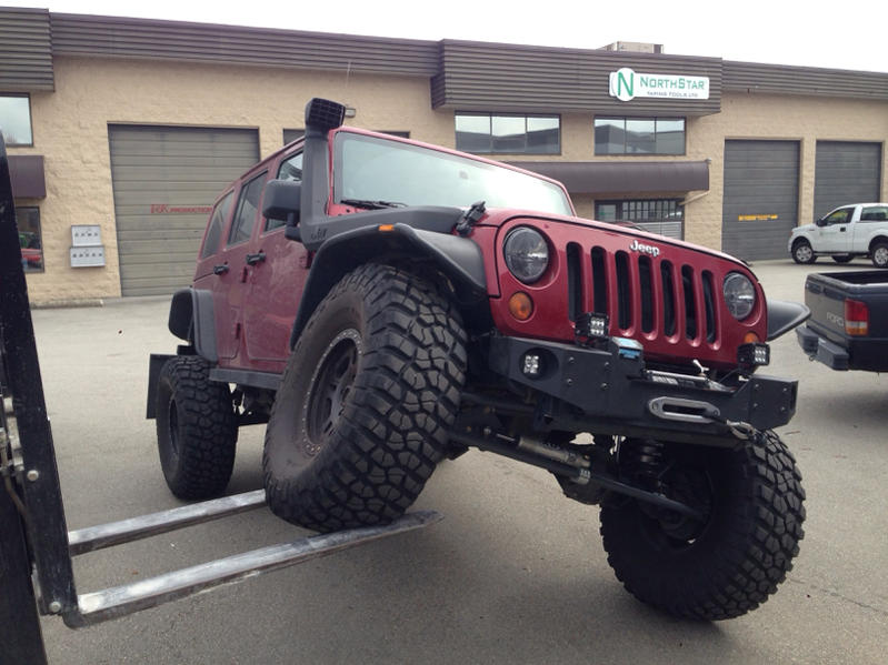

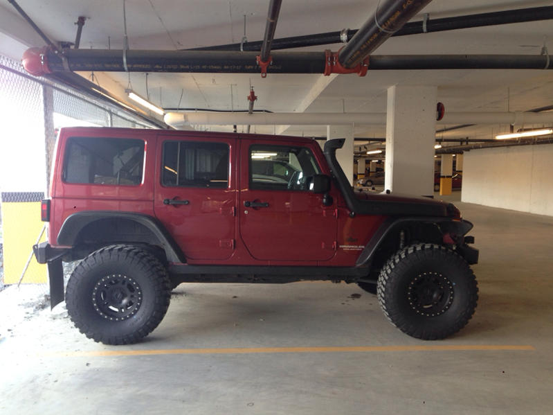

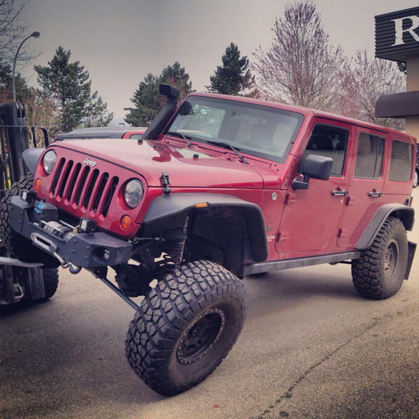

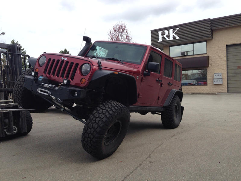

If you're stuck on 37's ( cant argue that, they do look badass on a 4 door ) 3" is good enough, proper back spaced wheels is needed and flatties.
I run synergy coils. Beautiful ride on and off road. Progressive rate coil too, so they're long.
Tuff country isnt even spoken of on here. I do know they run progressive or dual rate springs though. Cant comment on quality. But the kits are pretty incomplete. You dont need 4". It gets tall for a DD and can cause issues after a few miles are on the jeep.
Heres mine on 37's with only 3" lift.
