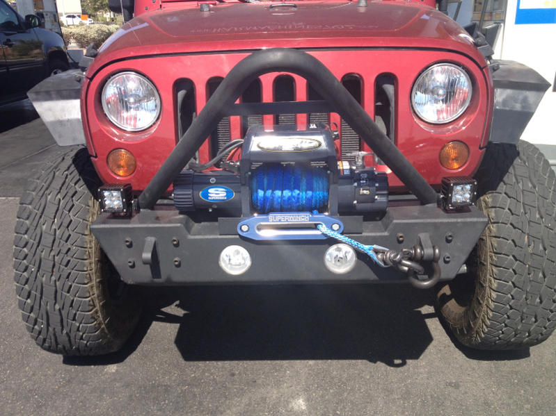

Don't need to relocate the vacuum pump, just flip it upside down.
With the stinger I had to raise the Superwinch Talon 12.5i SR 1/8" and it's a very tight fit but it works.
