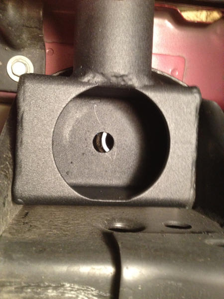

Just went to install my rock rails and the passenger one fit perfect and the drivers side won't fit. I started measuring and sure enough one of the mounts is 1/4" off. You'd think by now they would have a jig to ensure proper position. Disappointing experience... I can redrill the hole, but it's a pain in a $&S.

this isnt the first time ive seen / read about this on the rock rails. its very minor, but i do agree that you would think this is an easy thing to get right.
that said, for the money its hard to beat these rails. there are some nicer more expensive rails on the market but these seem to get great reviews (from me included) and they do their job well.

Yep... They seem stout. Redrilled and installed.

Same thing with mine. Rear-most mount on drivers side. Nothing a little carbide-tipped die grinder couldn't fix in 30 seconds though.

I helped install mine this weekend. Noticed that we had to grind more off of some washers than others.

If I was going to take a guess, I'm thinking that Ace has a jig set up to weld these. So all there stuff is probably pretty close to dead on.. But I can measure the samplings on two Jeeps and get some serious differences..
I'm not convinced that the problem is with Ace's product

I measured both rails and it absolutely the rail. I think I said 1/4" off. Just say'n.

Per their warranty, I think they'd replace them if you contacted ACE.
You'd just have to deal with the hassle of shipping & RMA.

I got mine last week - passenger side fit perfect..... driver side was off about 1/8" on the rear hole. I loosened both front bolts to let the rail drop down and then used a small pry bar and got the rear bolt started.
I love everything about the bars EXCEPT the grinding of the dang washers.
