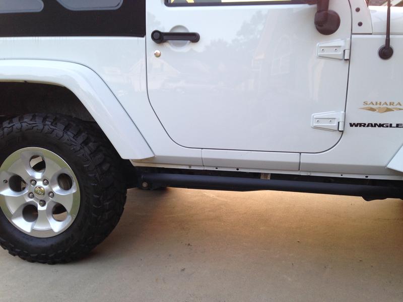

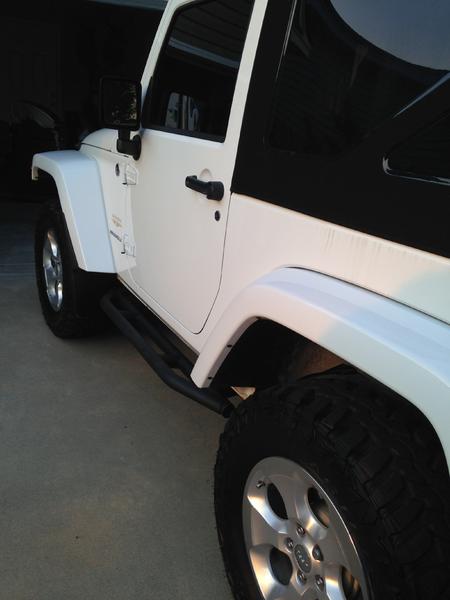

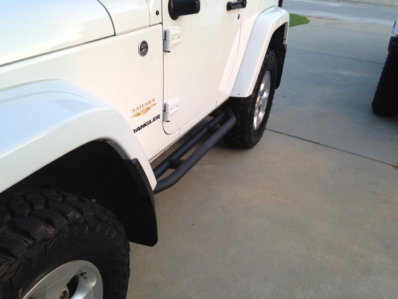

It took all of about 20 minutes to get my ACE rails installed yesterday afternoon. I do believe that was the easiest upgrade thus far on my jeep. I had removed the stock Sahara steps the day before, but that was 3 minutes a side, 4 10mm bolts and 2 15mm (I think) and it popped right off.
The install is very strait forward, and you'll need a buddy to help mount them. They aren't terribly heavy at a combined weight of 67 pounds (2 door), but it would suck trying to do it alone. First step is just removing the two body mount bolts, which are 18mm. My buddy Stu did the dirty job of grinding about 1/8" on two sides of the body mount washer. This is just to fit the bolt/washer into the slider's mounting hold. Once that was done, hold them up and tighten the bolts. Done. I think they turned out great. I will most likely plastidip the pinch seam at some point, but that's small stuff. It doesn't look as horrible as some people will make it out to be. The best part is there is plenty of room to plastidip that seam even with the sliders installed. So no worries. so, who wants pictures!!!!!

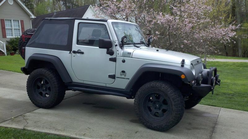

Looks great! I added the MOPAR Rubi rails when I installed mine. Filled in that gap and added a bit more protection.
X2, I did that same with my 4dr.
Thanks for noting that, was just going to ask if these were the ones that can use the stock rubi rails. these look great and look like they will take a door hit before the jeep will.
Here is a picture of what it looks like with the MOPAR rails installed....

^^^ no fitment issues with that?

I really like the way the rubi rails look with the ace sliders. But I try to avoid adding weight when possible. The rubi rails honestly don't serve any purpose when installed with ACE sliders, other than aesthetics. I personally would rather have the weight savings and just plastidip the seam, which end game has the same result, with out adding 70-80 pounds of weight to the jeep.
