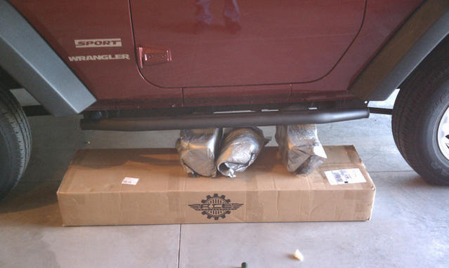

UPS delivered my rock sliders tonight. Two big boxes, each labeled "driver" or "passenger". I wasn't going to wait for help, so I tackled the job myself. Bolts came out easy enough. I had to grind quite a bit off one washer. I'm not sure if it was the washer being too big or the rockslider opening being too small. I had to improvise a way to hold them up while I got the bolts started... the answer was in the boxes! I used one of the shipping boxes and the foam shipping material to prop up the bar for mounting. It worked perfect!

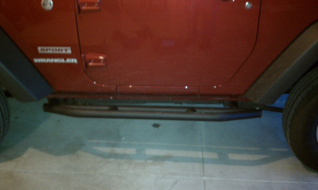

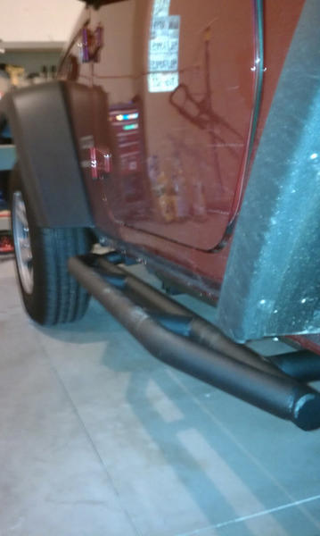

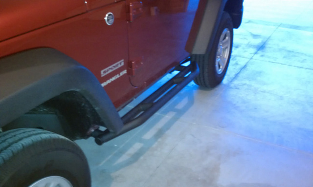

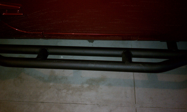

After a bit of a torture getting the bolts started, the tightened right up. I set the torque to 80lbs and torqued it down till it clicked. Here's the pictures from a few angles. Sorry for the poor pictures, camera phone and all! Overall I was impressed with the weld quality and powder coat. Seems like a very tough product. I'll check the torque in a few days, I'd think those bolts might be suspect of working their way lose.
