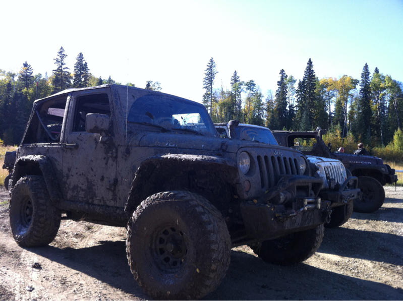

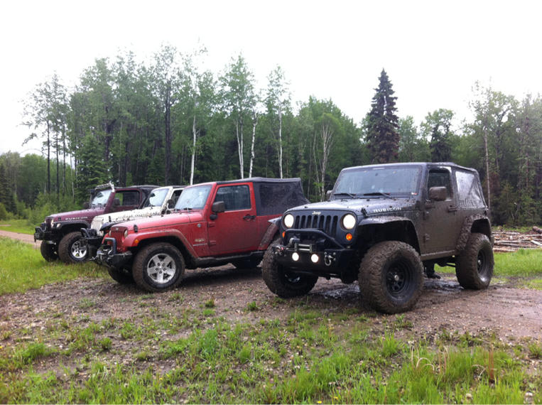

You need to grind off a bar behind the bumper so you need a grinder or sawzall.
Get 8 small nuts to mount between the oem fog lights and the bumper. This will recess your fog lights back into the bumper a slight bit, making it look beter and i think prevent trail / road damage.
Make sure you tighten the 8 bumper mounting bolts real tight mine came loose.
Its heavy you need two people. Plus also for the mounting bolts to hold nut on interior while other tightens bolts.
