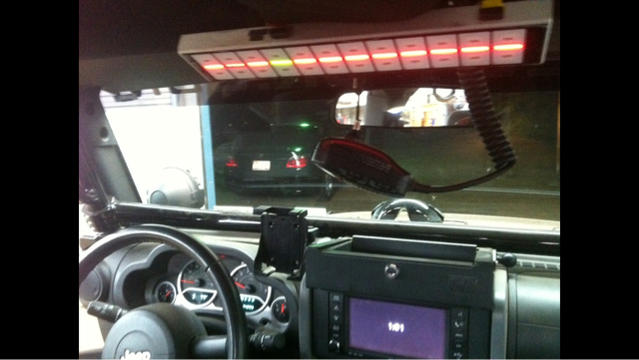

I love my ram mounts. Have them in all my rides including my 4 wheeler for my magellan meridian gps and sealed case for iphone.
