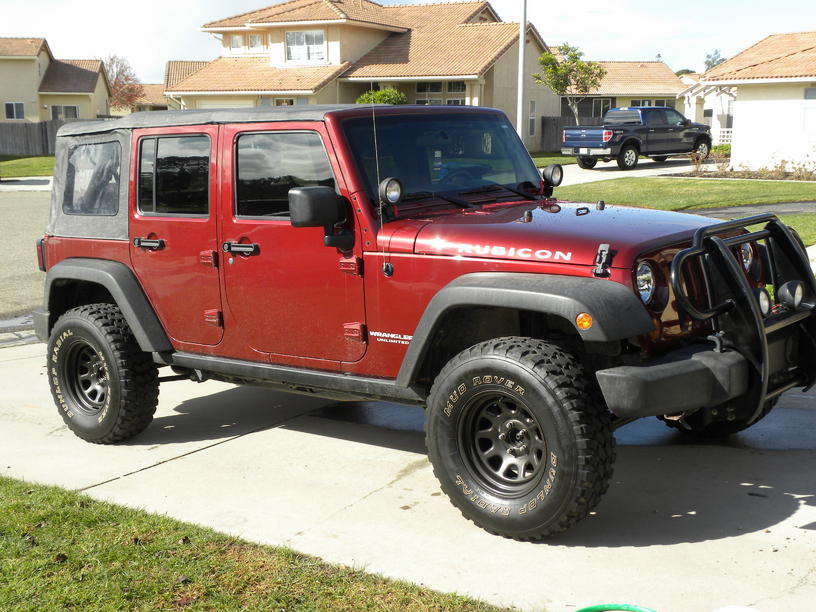

Rig: 2008 Wrangler Rubicon Unlimited
JC whitney brush Gaurd $250.00
Daystar 1.75 inch front and .75 inch rear. $49.00 each
Craiger 16 wheels and five wheels and 285x75r16 tires off a wrecked TJ $350.00
(Does not include elbow grease sand paper and paint for the wheels)
1 1/2 inch wheel spacer/adapter (from 5x5 to 5x4.5) Ebay $129.00 for 4!!
K/C windshield light mounts 29.99
I got the 50w lights for 14.99 apiece from auto zone
I got the wiring,switch,connectors ect.. on the same isle at auto zone $29.00
I did all the work in my driveway with simple hand tools and a few beers!
