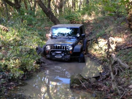

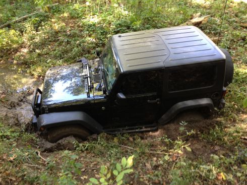

I'm looking to upgrade to a front Teraflex 44, because it's stronger than a regular Rubi 44. Then with alloy shafts "I am told" it gets about the same strength of a stock 60. Also a "mechanical locker", because I have seen air hoses and elec. lines snag, break and pinch in poor conditions.
What I'm getting at is if you're going to spend the money, do it as well as what you can afford. The above set up will run me close to 6k. I feel it's worth the added strength.
Not that any of the above would have helped my last situation...
