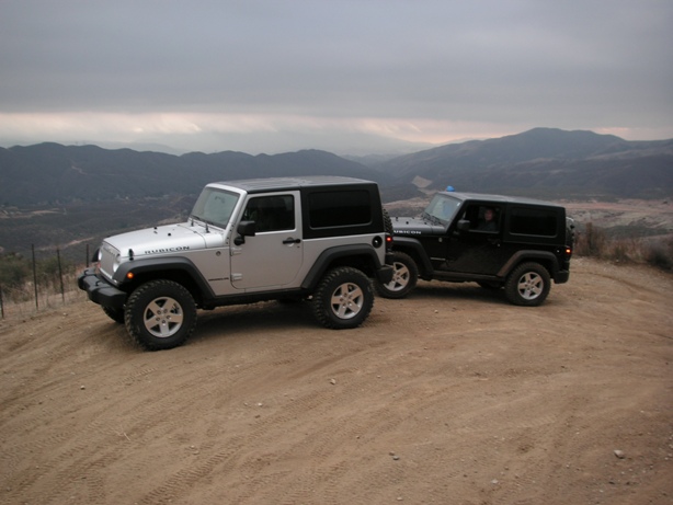

I noticed my Rubicon when new wandered pretty terribly on the highway too.
I intalled a 1.75" Daystar/Procomp lift and 33" BFG mudders and it actually seems a lot better, so it could be a lot to do with the factory 32" tires. If you look at BFG's or the TireRacks web sites you will see that the 255/75-17 mudders are a different style than any other mudder they sell.
Here are the differences between the 32's and 33's.
Load Rating - 2405lbs vs. 3305lbs
Speed Rating - "C" vs. "D"
Max PSI - 50psi vs. 65psi
As you can see the 33's are a beefier tire, so I imagine the sidewall is much stiffer. Is this the cause of the wandering, I don't know? But, I would think a "mushy" sidewall could cause some weird habits?
The only thing I noticed with the bigger 33's (285/70-17's) is the ride seems a little harsher when I hit something ubrupt. I'm sure this is due to the fact the sidewalls are beefier.
I'm running the factory recommended 37psi in the 33's now, but I'm going to try lowering it to 32psi and see if I can get rid of the ubrubtness. I dropped them to 20psi last weekend while 4 wheeling and it made a HUGE difference in ride quality.
End result - even with the small 1.75" lift, with the new 33's my Jeep doesn't wander nearly as bad.
