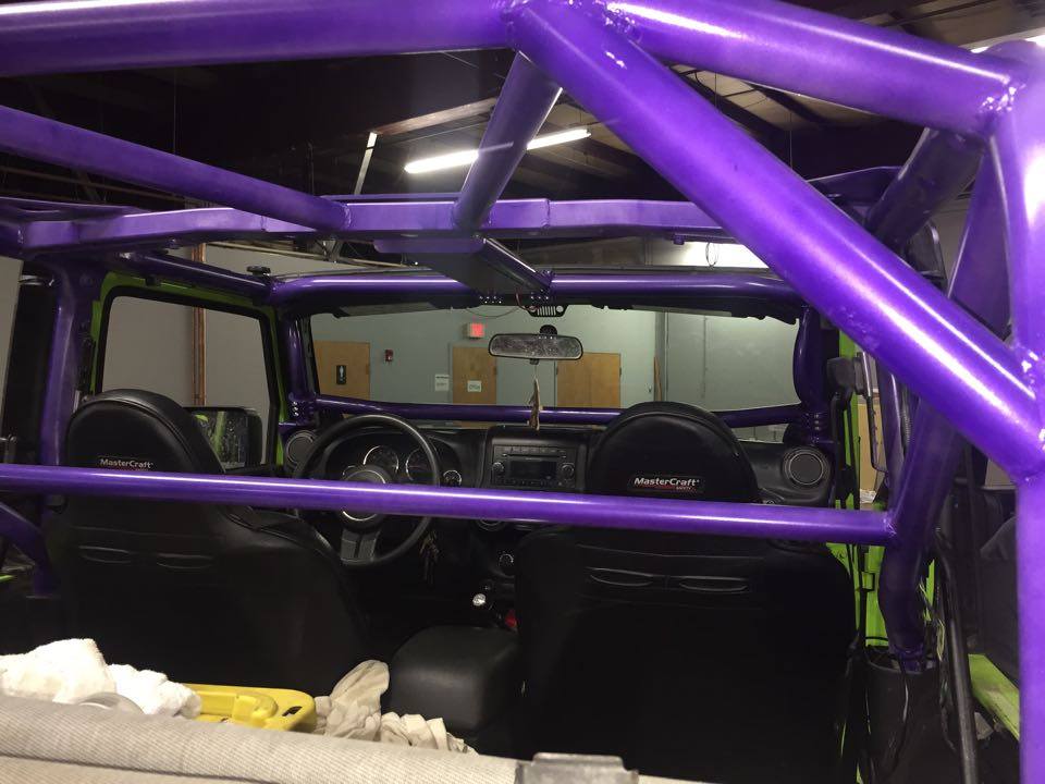

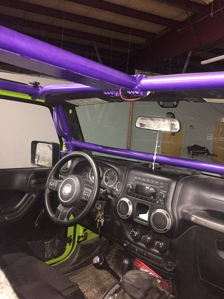

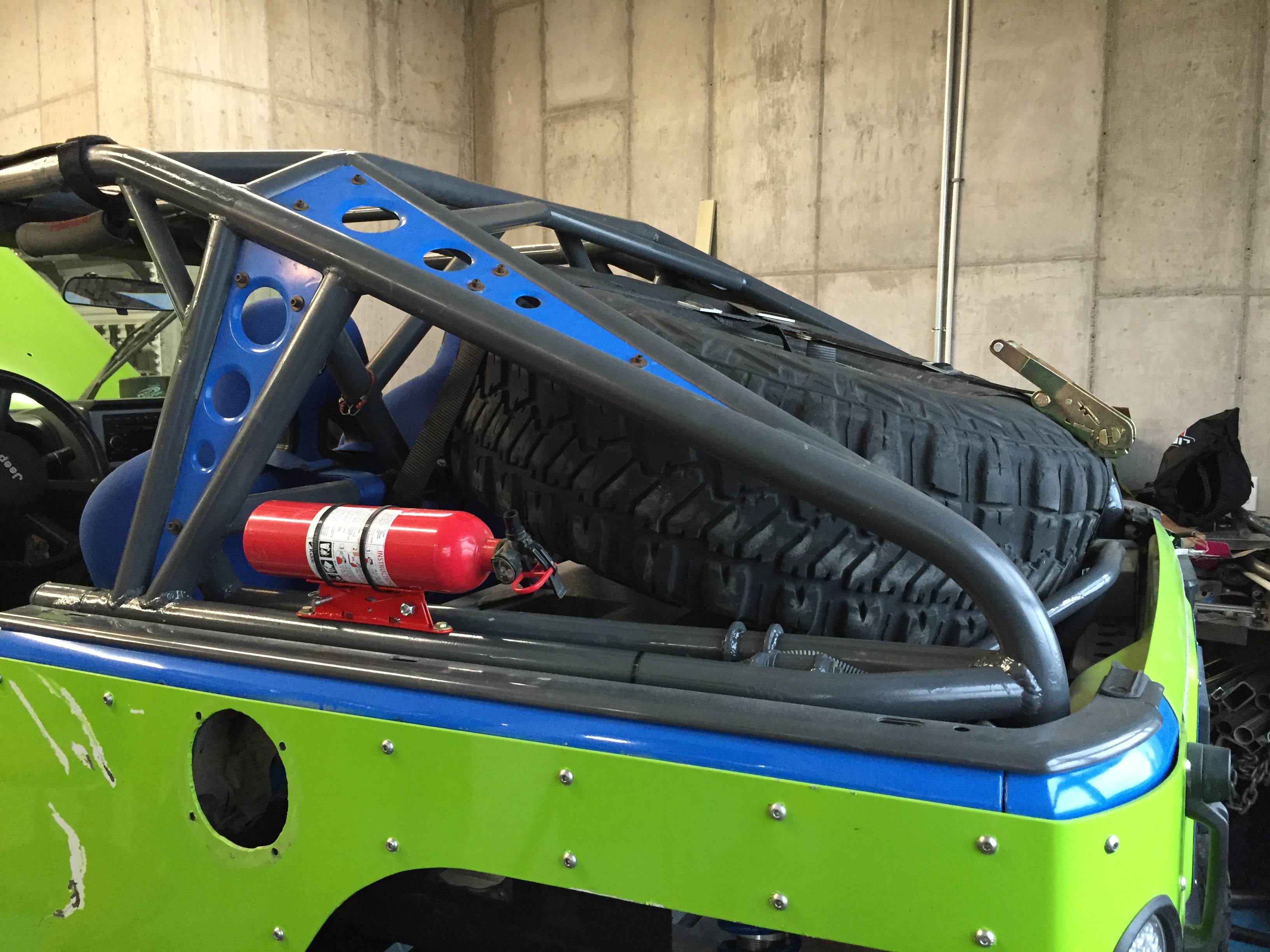

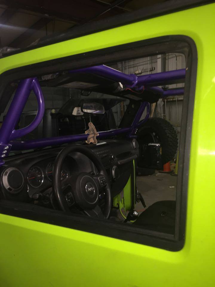

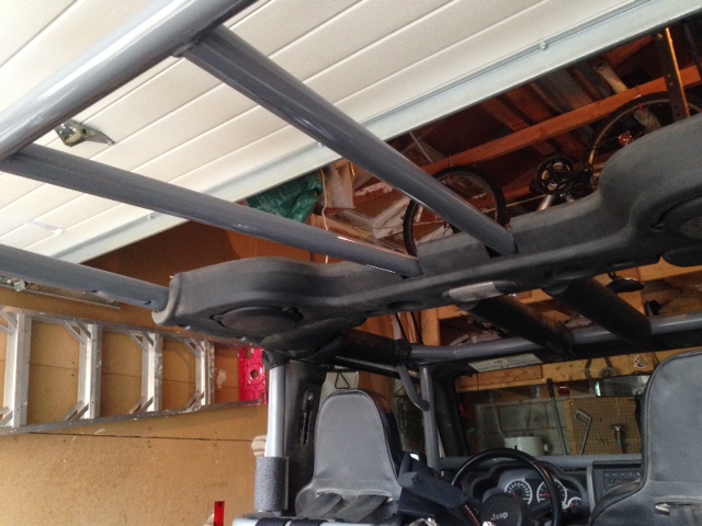

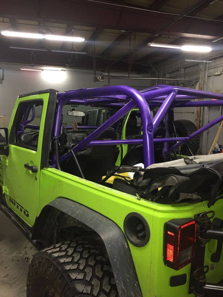

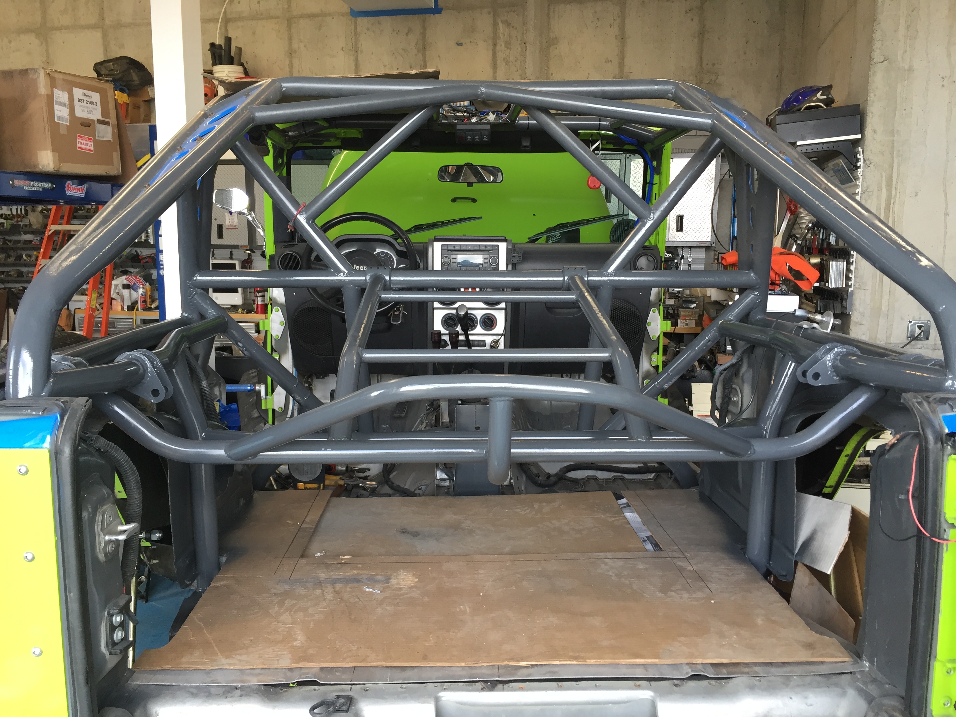

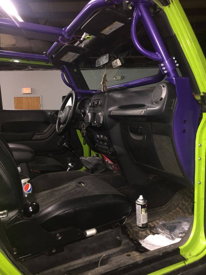

The front of my JKU is similar to the Gen 1 Synergy cage
The rear uses Poison Spyder's C-Pillar Kit with new spreader bars & replaced the cross bar.
The A & B pillars are tied into the frame.

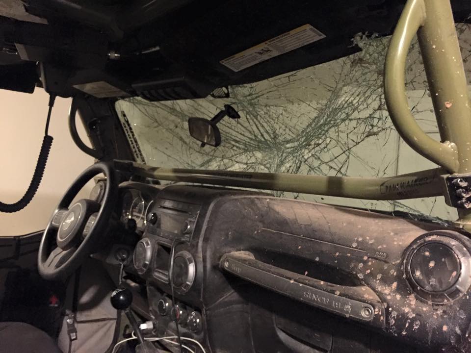

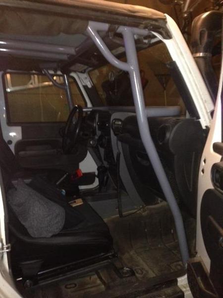

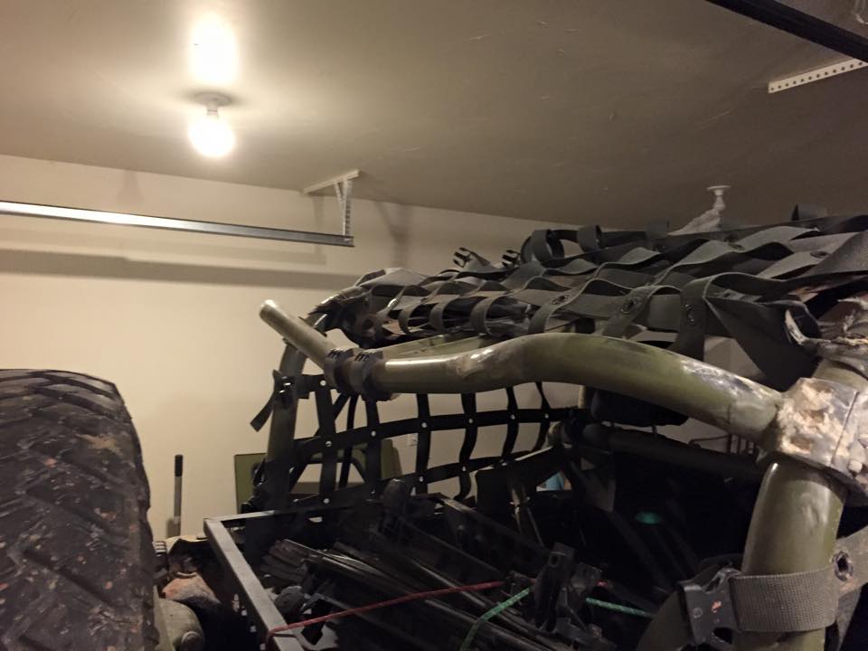

My buddy had the rockhard cage and went ass over end with a 1/2 barrel roll in there and the jeep survived. We flipped the jeep over and drove it home back to Toronto from Moab lol. If you want to go bolt-in then I would go with rockhard without a doubt.

This is the picture (top one of the rear) that is concerning and highlights a needed design improvement. More likely to injure a backseat passenger than save them. There should be supports on each corner.
Nice job on the cage in your Jeep though. Looks good.

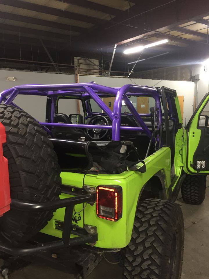

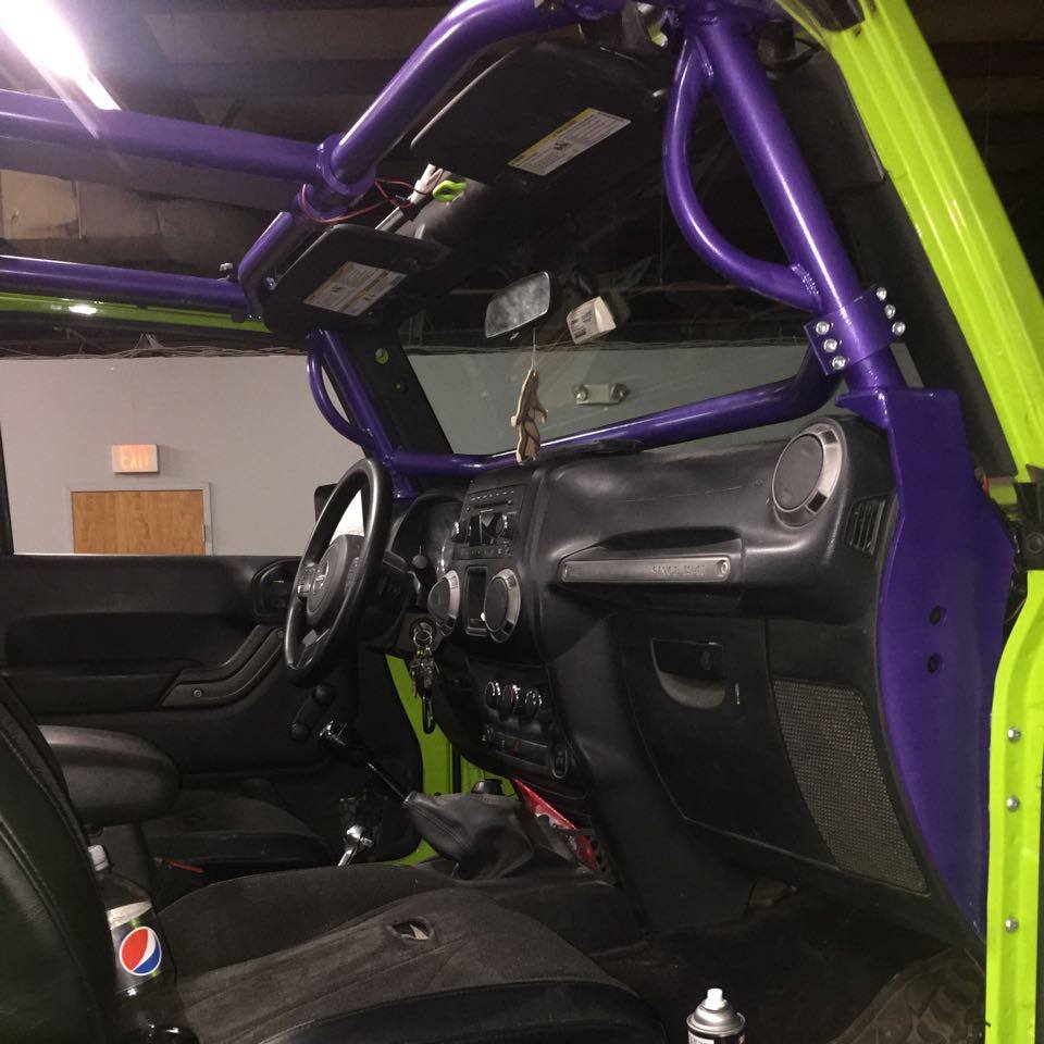

so I went rockhard bolt in front and synergy rear weld in! I went bolt in front has I have to be able to get into the dash if something goes wrong.

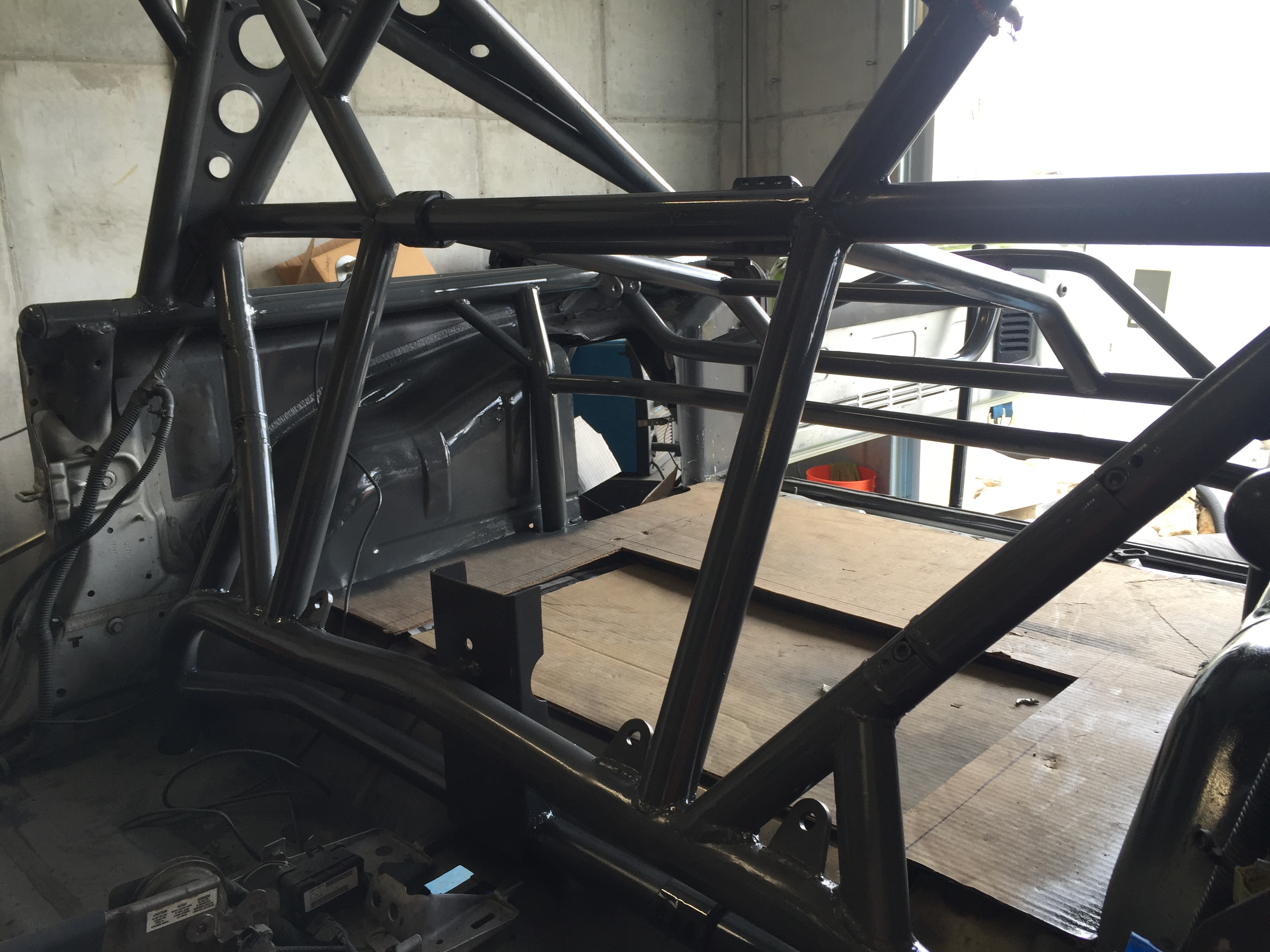

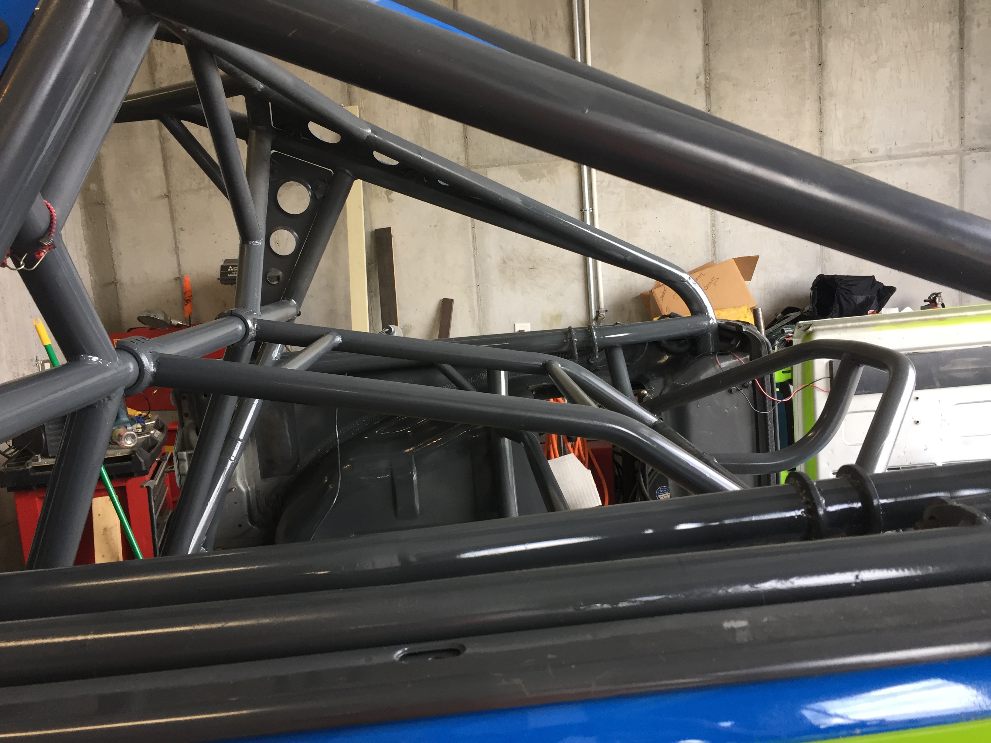

Just got done doing some cage work in the rear. Still need to tie the A pillar in but its plenty strong the way it is now.

Both roll cages came out awesome!! Definitely like that slick back roll cage with tire carrier integrated on the back Dirtman..
