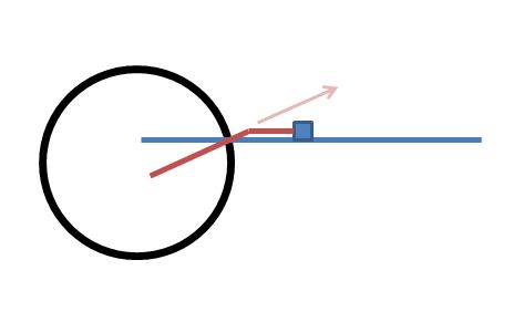

Thanks! Makes sense. I was looking at the Synergy low arm I got and it is angled like in the (crappy) diagram below. Therefore, the impact does not go directly to the pivot point on the frame. Instead it also creates a torsion effect like when using a lower bracket to hold the low arm. It has been working fine so far, even though I never tried the other to compare.

Originally Posted by Sahara_Maverick
Thanks! Makes sense. I was looking at the Synergy low arm I got and it is angled like in the (crappy) diagram below. Therefore, the impact does not go directly to the pivot point on the frame. Instead it also creates a torsion effect like when using a lower bracket to hold the low arm. It has been working fine so far, even though I never tried the other to compare. <img src="https://www.jk-forum.com/forums/attachment.php?attachmentid=569210"/>
The force is still applied to the frame mount as if it was a straight arm. The arms are bent for clearance.
