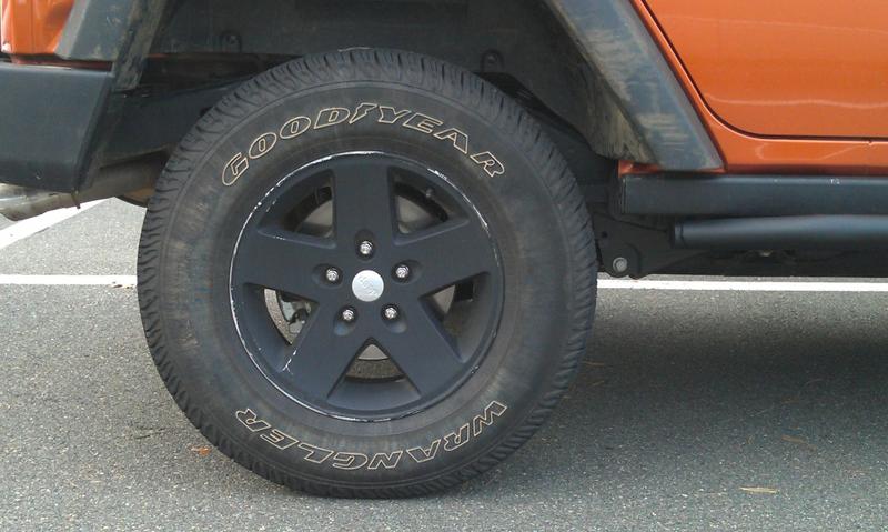

Ah thanks. I know with a 2.5 inch lift on a 4d, the amount of being off center will be minimal, however is there a good way to see how offcenter it is? I mean here is what I currently have, I plan on tossing in some spacers to go with the coils/shocks just to yield a bit more lift. how far back can it be pushed, all these adjustments seem like they net not even a few inches, I just want to make sure I can have everything set perfect
Name:	rear wheel.jpg
most of my concern comes from trying to get rid of flightyness on the highway, as well as stuffing some 35s in there

flightyness on the highway is caused by a lack of positive caster. installing a set of adjustable FRONT lower or upper control arms will allow you to make this adjustment.
