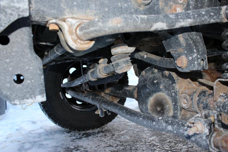

I have a cheap lift, and my 3" is more like a 2-2.5" I also added a bumper and winch so I'll add 1" coils spacer at 4 corners to raise it little. So far, my TB is the stock one and of drag link also.
So as I said, at front, I'm still stock on track bar and drag link, my lenght of lift doesn't maybe required or justify the use of flip drag link with track bar bracket, because my trackbar and drag link are almost parallel, as picture below
So If I had a 1" coils spacer maybe I don't even need to upgrage those pieces because my 4" would be infact more a 3".... But when I gonna replace coil with a real good suspension lift as Teraflex example...I guess at a realy 4"or 5" lift I would need to flip drag link and raise track bar.....we'll see !
With coils spacer added, if I feel something bad on steering I guess I could upgrade my stock track bar to an adjustable one. Also, at same time I'll had coils spacer I'll install my new steering damper I just bought from you with a bracket to flip damper over the tie rod.
What do you think ?!

Alright if it were me I would roll with what you have. Save the money for some good coils at whatever height you want. If you want 3" I would suggest synergy. Progressive rate both front and rear and they will settle at 3" loaded down with bumpers and stuff. They are designed to hold weight well. With these I would probably recommend the synergy drag link flip kit.
Or I would consider the new RK 2.5" triple rate springs with front adjustable trackbar.
