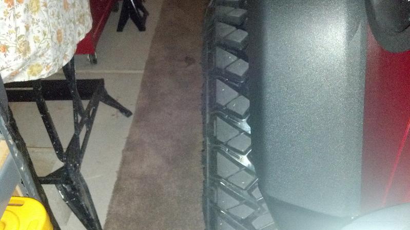

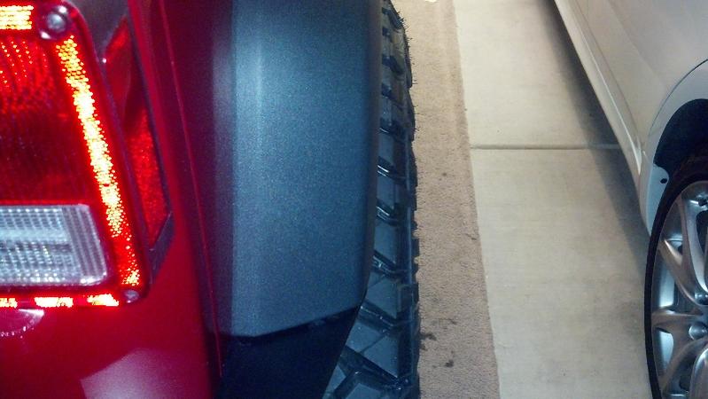

This is what I am dealing with. I will get some photos underneath tonight. Thx for the help.

That dosnt look anywhere near 2", but it surely isnt centered either. Something aint right.

I just realized the way the axle is off center is from the tb being too long. How much lift did you get in the rear?

thats way off. shouldn't be like that even with no relocation bracket. did you put the front trackbar in the rear or something...lol?
post pics of the trackbar and new bracket. something is off here for sure. at 2.5" of lift it would be like 1/4" - 3/8" off with the stock bar and no bracket.
